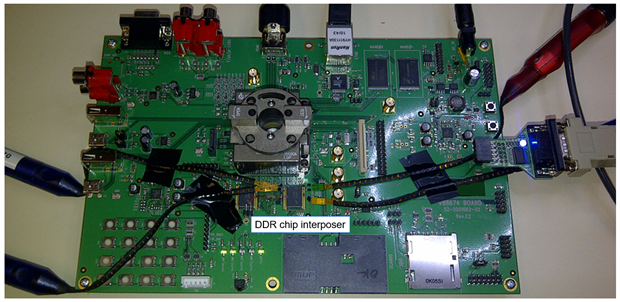

Figure 1: Embedded systems such as IoT devices often require chip interposers to gain access to signal lines on DDR memory
Figure 1 depicts an embedded-system board that encompasses a number of serial-data standards, including DDR3, HDMI, Ethernet, and USB. The DDR3 chip, near the center of the board, has solder-in probes connected to it by means of an interposer (Figure 1).
