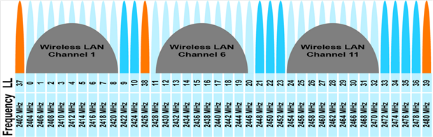

Figure 2: Bluetooth Low Energy slaves advertise on channels 37-39; BLE masters listen for these advertising packets and send a Connect Request to slaves
Let's look at Bluetooth Low Energy (BLE) advertising packets and how they might be analyzed using RF-burst amplitude and frequency demodulation. Referring to Figure 2, a BLE slave advertises on channels 37, 38, and 39, which are assigned to 2.402, 2.426, and 2.480 GHz, respectively. BLE channels are space 2 MHz apart. A BLE master listens for the advertising packets and sends a
Connect Request to a slave it wants to connect with.One metric we want to look at is how centered each of these packets are around its channel's mean frequency, and how much the spectral content is spread around that mean frequency.

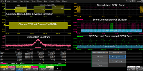

Figure 3: An amplitude-demodulated BLE advertising burst (shown in top-left grid above) reveals details regarding period, burst width, duty cycle, and more
Referring to Figure 3, the top-left grid shows the BLE advertising bursts. Using the oscilloscope's amplitude-demodulation math function, we can create a burst envelope waveform with which to measure the bursts's width, period, and duty cycle. These can be seen as the light-green trace bordering the burst envelope waveform.
The next grid down at left is a zoom trace of the Channel 37 burst. Below that in magenta is a fast-Fourier transform of that signal to measure its spectral content. Spectral analysis reveals that the burst is centered around 2.402 GHz and that most of its energy is contained within the desired 2-MHz bandwidth as expected.
The frequency demodulator math function can also be used on the GFSK-modulated burst to demodulate it into its serial-data bit stream (Figure 3, top right grid). The data can then be decoded to read the packet's preamble, axis, address, the advertising channel's header, and the packet's payload data directly on the oscilloscope.
