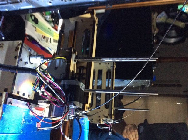

This has been tricky, simple for the z extension. I replaced the rods and screw shaft with larger ones. It extended my z from 100mm to 250mm. But I had to go into G-code and change the maximums there to get it to recognize the extra size. Now I'm printing larger shaft holders for the x increase. I will replace the bed once the dimensions. Then with an increased z and x I will start the y.

  • bradnorwood
    bradnorwood over 11 years ago in reply to DAB
    Taller z rods and screw drive
  • bradnorwood
    X Plateform with new rods

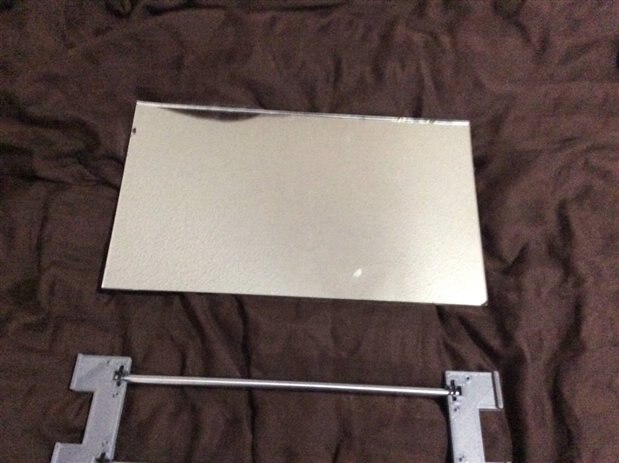

  • bradnorwood
    bradnorwood over 11 years ago in reply to bradnorwood
    MIrror or for new build plate

  • bradnorwood
    Not easy! Plus I ran into my sensor not working due to being a metal detecting sensor, so I have to add metal tape lol
