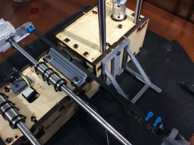

This has been tricky, simple for the z extension. I replaced the rods and screw shaft with larger ones. It extended my z from 100mm to 250mm. But I had to go into G-code and change the maximums there to get it to recognize the extra size. Now I'm printing larger shaft holders for the x increase. I will replace the bed once the dimensions. Then with an increased z and x I will start the y.

    Not easy! Plus I ran into my sensor not working due to being a metal detecting sensor, so I have to add metal tape lol
  • bradnorwood
    bradnorwood over 11 years ago in reply to DAB
    Yeah, getting the sensor to pick up was a choir, I had to put down metal tape and then my blue tape to get it to stick, but the plus side is my plate cost $3 and some time instead of $60-100 for a solid aluminum one this size is 12" x 8" and next i will work on the z and y to get it to 12 x 12 x 12

    Old print size with new size, the z was the easyiest to up grade, I actually printed the pipe up right, new size is 90mm x 115mm x 300mm and wow hahaha

    With the increased x the back side needs more support
  • bradnorwood
    bradnorwood over 11 years ago in reply to bradnorwood
    A belt guide was added and the x right stabilizer

    I'm relocating the Printrbot board also.

    I found myself wanting bigger parts and items, I see how Printrbot needs a few minor upgrades, it's a great starter kit, I built this one and did not order it pre assembled. The original string was very poor quality so I up graded to the gt2 belts. Now I see the bearings being next, I ordered some from adafruit, I see there is a weakness in the x bearings and z ones too. Once I'm done, I should get really high quality prints at small and large sizes. Right now I get small parts easy but the larger ones need a better bearing and mounts to keep it level.
