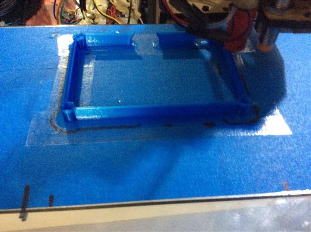

This has been tricky, simple for the z extension. I replaced the rods and screw shaft with larger ones. It extended my z from 100mm to 250mm. But I had to go into G-code and change the maximums there to get it to recognize the extra size. Now I'm printing larger shaft holders for the x increase. I will replace the bed once the dimensions. Then with an increased z and x I will start the y.

    Printrboard box top completed 3 hours and 3 minutes.

    115 mm x 80 mm Printrboard case top cover held in place better with double side tape...

    I found myself wanting bigger parts and items, I see how Printrbot needs a few minor upgrades, it's a great starter kit, I built this one and did not order it pre assembled. The original string was very poor quality so I up graded to the gt2 belts. Now I see the bearings being next, I ordered some from adafruit, I see there is a weakness in the x bearings and z ones too. Once I'm done, I should get really high quality prints at small and large sizes. Right now I get small parts easy but the larger ones need a better bearing and mounts to keep it level.

    I'm relocating the Printrbot board also.

    A belt guide was added and the x right stabilizer
