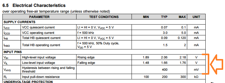

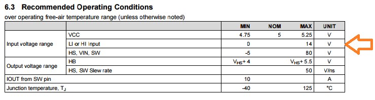

    Question is, do the peaks get anywhere near the input switching voltage? Are they CMOS levels on the inputs or TTL? Hopefully they're CMOS. (I can't look at the datasheet because I can't see one on the product page - maybe you have to register or something.)
    The datasheet is available as PDF only. No web version for this product:
    http://www.ti.com/lit/gpn/lmg5200
    We're looking at the signals that will go into LI and HI input.

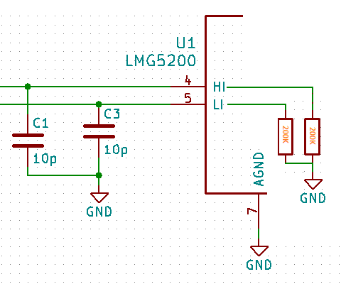

    Jan Cumps over 9 years ago in reply to jc2048
    This is a simplified schema of the input circuit. The PWM signals enter left.
    The two 10puff caps are on the PCB, as close as possible to the GaN input pins.
    The 200K represent the nominal value of the internal pull-down resistor on the GaN die.
    I measured before the 10puffs, without the GaN IC mounted. I'll redo the exercise once I have the LMG5200 back in place.

    I don't understand what I was doing with the datasheet. I've been back to the product page and there is a link to the datasheet. How strange.
    I see what you mean with the previous capture. That's the ground lead (and possibly, in some degree, the probe itself which isn't really intended for looking at these kind of edge rates). So that really leaves us up in the air. My confident assertion that the ringing is always worse than you see isn't necessarily true (you are testing the test equipment at the same time as the board).
    The input levels are TTL, but with hysteresis. I would be concerned with the ringing you show, given that the oscilloscope may be under-reporting. The peak of one of the ringing cycles has to get to 2V. If it does, do you get shoot-through of the FETs or is there logic on the chip that prevents that?
    The 200k isn't a terminator, it's just a light pull-down to ensure the input remains in the inactive state if nothing is connected to it. The stripline across the board will have an impedance of something like 40-100 ohms depending on where the ground underneath is and the width of the track. For end termination the resistance needs to match, but that assumes that the driving end can actually drive it which might not be the case if it's a weedy processor pin. If the processor output has FETs with a channel resistance of 20 or 25 ohms, you'd be better off with the series termination at the sending end - basically you add resistance to bring the channel resistance up to the line impedance, so if the channel resistance is 20 ohms and the stripline is 50, you'd have an external 33 ohm to match.
    What is the width of the track and the height above the ground plane?
