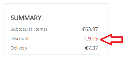

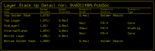

The price without shipment for this board is 65.12€. Shipping was 7.37€. The coupon got me 9.15€ off ($ 10). Totals to 63.97€

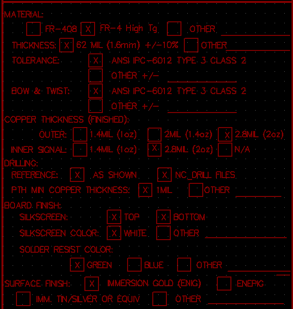

This design requires 2oZ copper layers. My budget can't carry the cost of such a board - so I will not be able to draw full current out of my design.
This is a compromise, one of the many I had to make. I tried to avoid compromises in the design, but did make them when ordering.
Getting a board that has enough copper on it will not require a design change. It's just ticking a different option when ordering and coughing up the monies.
I'd rather do that after I validated that I didn't make mistakes in the PCB layout.

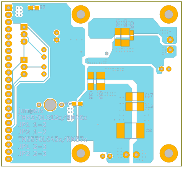

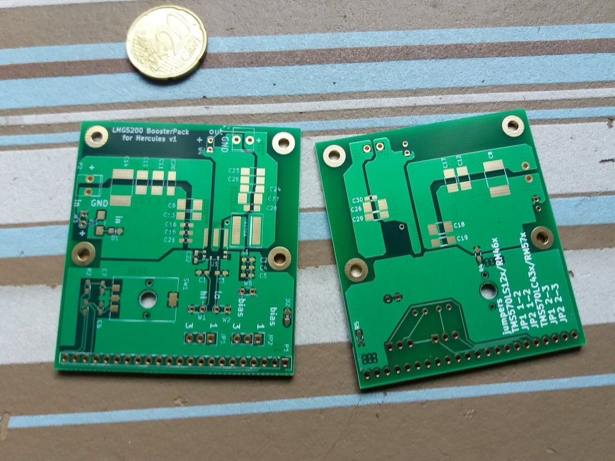

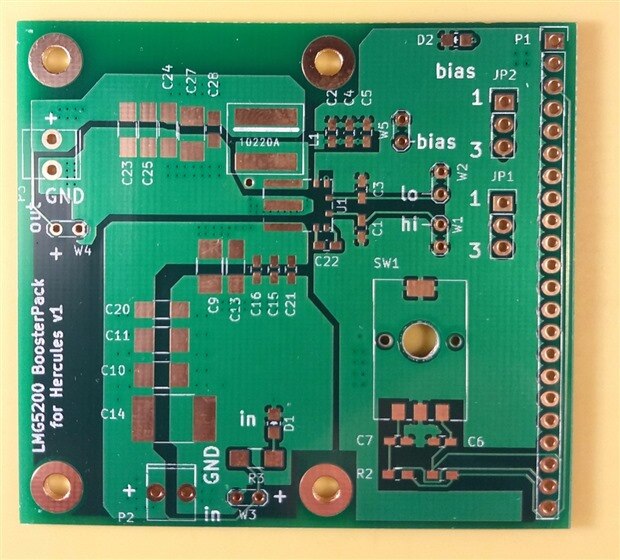

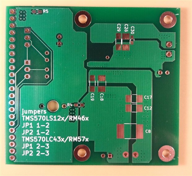

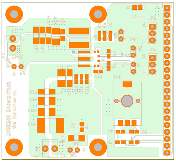

Just like previous designs I did with OSHPark, the Seeed boards look very good at first inspection.
This design is 4 layers, so I have no mechanism to look at the two inner layers. The top and bottom layer look very nice, so that's a good sign.
In the images below, the artist renditions on the left side are generated by the Seeed portal.
The photos on the right side are the actual thing. Click on them to get a detailed view.

    I'm happy that the (somewhat) complex footprint of quadrature encoder - with one oval and two round mounting holes fitted perfectly.
    The two screw terminals however, P2 and P3, are a complete goof-up. The holes are too small, the distance between them is wrong and the total size of the footprints doesn't match the component.
    I have to check how that happened, because I made this footprint myself from the data sheet. (wrong part ordered or delivered, wrong drawing selected in the sheet, inch/cm switch, I don't know yet)

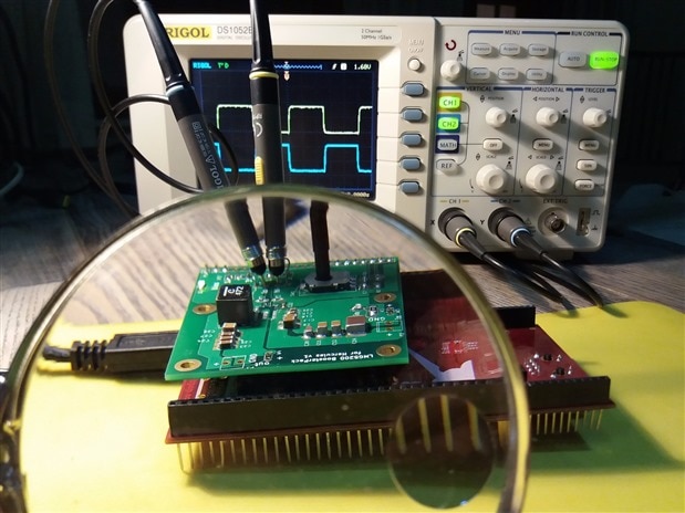

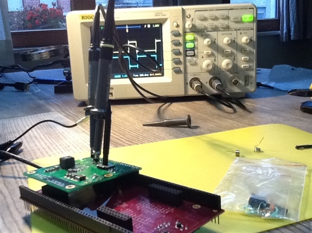

    High-res probing photo:

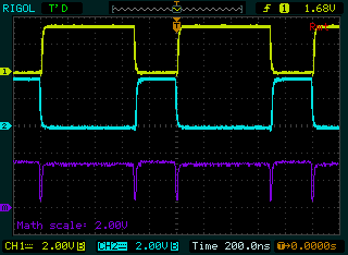

    especially for DAB, I've taken care to probe with signal integrity in mind.
    The absence of patch wires -  and using ground springs in stead of probe crocodile clips - does the job.
    I've made all test points on my board in a way that allows ground clip probing.

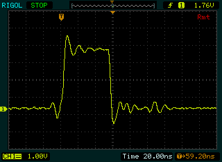

    Focus on ringing. It's acceptable, I think.
    Rising edge of channel 1:
    Falling edge of channel 1:
  • jc2048
    jc2048 over 9 years ago in reply to Jan Cumps
    This is good. Real-time blogging.
    "Focus on ringing. It's acceptable, I think."
    With respect, I might disagree.  Unless you have a scope with a high bandwidth and an active probe with very low capacitance, ringing is always worse than you see on the screen.
    You have 3 cycles of ringing in 30nS, so that's 100MHz. You're using a 50MHz scope (if memory serves me right). So the scope is 3dB down even at the 50MHz - maybe, it depends what they think they mean by a 50MHz bandwidth, what the sampling rate is, and what the reconstruction software does - how much down is it at 100MHz?
    You're using ordinary probes with 12pF or 15pF load capacitance. That will damp the ringing a little. To judge the effect, look at the signal with one probe, add the second probe, and see what difference it makes.
    Question is, do the peaks get anywhere near the input switching voltage? Are they CMOS levels on the inputs or TTL? Hopefully they're CMOS. (I can't look at the datasheet because I can't see one on the product page - maybe you have to register or something.)
    I'm not saying it isn't ok, just that you can't really say for sure.
    You could deal with it (if it were a problem) by terminating the line. Usually you'd go for a single series resistor at the sending end to absorb the return signal (with a single transmitter and a single receiver), but you probably wouldn't want to modify the processor board. In this case you could terminate at the end. If you put a capacitor in series with the termination resistor it cuts the dc dissipation. You'll be able to judge what the termination is doing because although the scope doesn't give you accurate  measurements it will show you the ringing declining (ie if the scope shows you've halved it, you've halved it even though you still don't know what the levels are). If you ac terminate then there's no reason you shouldn't do it to the supply if that's what the plane around the tracks is.

    Jan Cumps over 9 years ago in reply to jc2048
    Jon Clift wrote:
    ..."Focus on ringing. It's acceptable, I think."
    In comparison with my usual captures I mean image.
    This was my capture of the original board:
    I was happy that DAB wasn't close by when I posted that. He'd have hit me with several big stones I think image

  • jc2048
    I don't understand what I was doing with the datasheet. I've been back to the product page and there is a link to the datasheet. How strange.
    I see what you mean with the previous capture. That's the ground lead (and possibly, in some degree, the probe itself which isn't really intended for looking at these kind of edge rates). So that really leaves us up in the air. My confident assertion that the ringing is always worse than you see isn't necessarily true (you are testing the test equipment at the same time as the board).
    The input levels are TTL, but with hysteresis. I would be concerned with the ringing you show, given that the oscilloscope may be under-reporting. The peak of one of the ringing cycles has to get to 2V. If it does, do you get shoot-through of the FETs or is there logic on the chip that prevents that?
    The 200k isn't a terminator, it's just a light pull-down to ensure the input remains in the inactive state if nothing is connected to it. The stripline across the board will have an impedance of something like 40-100 ohms depending on where the ground underneath is and the width of the track. For end termination the resistance needs to match, but that assumes that the driving end can actually drive it which might not be the case if it's a weedy processor pin. If the processor output has FETs with a channel resistance of 20 or 25 ohms, you'd be better off with the series termination at the sending end - basically you add resistance to bring the channel resistance up to the line impedance, so if the channel resistance is 20 ohms and the stripline is 50, you'd have an external 33 ohm to match.
    What is the width of the track and the height above the ground plane?

    For the time being, a scope capture of the high side input, measured after the cap, with the IC in place (just soldered a new one in place).
    I'll redo this capture with the trigger point a little more to the left to capture the additional ringing after falling edge, then use cursors to measure the peaks of the rings...
    The ringing stops right at the edge of the screen. The last rising edge you see is also the last significant ring.
    I've uploaded the waveform in RIGOL DS1052E wfm format. If you have access to that type of oscilloscope, it's possible to load the file via USB and perform measurements on the scope.
