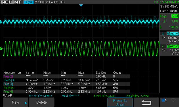

The -5Vout signal was oscillating because of an assumption I made regarding the ESR of the output capacitor so I replaced the C19 1uF output mlcc for a 10uF electrolytic capacitor and placed a 22uF electrolytic capacitor in parallel to C18.  That has stabilised the output and reduced the ripple down to 800uV with noise peak to peak of 3.95mV (mean.)  The 22uF capacitor also had a significant impact on the ripple output from the DC-DC investor which was 320mV peak to peak beforehand (no image in this post.)
Image 7
Ch3: Output of the DC-DC inverter
Ch4: -5Vout
To try and improve this further, I added a 10Ohm/10uF mlcc low pass filter after the -5V regulator (R20 populated with 10Ohm, R22 populated with 10uF and C34 populated with 0Ohm jumper.)  I also removed C18 0.33uF capacitor leaving just the 22uF capacitor for input.  This has reduced ripple to 680uV and noise peak to peak to 2.83mV (mean).  The LPF has reduced the output voltage from -5.011V to -4.85V but given its purpose - the negative input to OpAmps - this is not an issue.

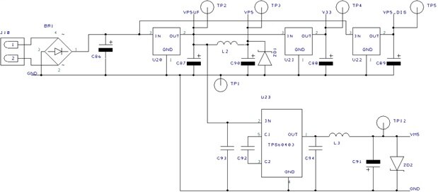

  • michaelkellett
    michaelkellett over 5 years ago +5
    If you add LC filters with large inductors you can very easily get issues with large voltage overshoots at switch on. You can mitigate this by carefully placed additional resistance to reduce the Q of…

  • michaelkellett
    If you add LC filters with large inductors you can very easily get issues with large voltage overshoots at switch on. You can mitigate this by carefully placed additional resistance to reduce the Q of the LC filter but this will often reduce its filtering effect as well. An alternative is to use zener diodes to clamp the rail but beware that there will be a large difference between the zener clamping voltage and its "zero" current voltage.
    This is the power supply from one of my designs - L2 and L3 are Bourns SRR0735A-681M and C90 and C91 are 100uF 10V polymer electrolytics with ESR about 0.016 ohms. (Kemet A758EK107M1AAAE016).
    The zeners are 5.1V BZX84.
    MK

  • jc2048
    jc2048 over 5 years ago in reply to Andrew J
    I'd still like to understand about the zener zero current.
    This is from a Vishay datasheet for the BZX84 series of Zener diodes.
    You can see that, for the true zeners, the clamping is quite soft. It gets better above 5V, where the avalanche-breakdown effect dominates.
    So, the 3.3V zener might clamp to 3.3V at the test current of 5mA, but it's over 4V with even just 50mA flowing through it.
