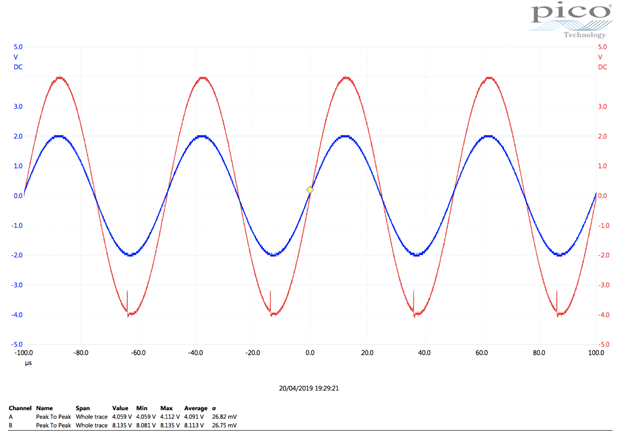

Previously, I had wound 20 turn and 40 turn coils, with 1.0 mm diameter magnet wire on 40 mm diameter formers, a UK standard waste pipe size. Alongside that I had wound a 100 turn coil with 3.75 mm diameter wire as a two layer coil on 40 mm and 55 mm diameter formers. This latter coil is predominantly for use with an injection test set, as it will take a much higher current than the little amplifier unit I have been building, is capable of providing.
As I have tested the amplifier with the 20 and 40 turn coils, I have found that the amplifier does not deliver enough output voltage to be able to provide the full 2 A current at the higher frequencies. As the frequency is increased, the impedance of the coils also increases. For the 20 turn coil, the impedance at 20 kHz is 1.93 Ohms and the amplifier can supply the full 2 A. For the 40 turn coil, the impedance is 6.05 Ohms and I could only supply 1.03 A at 20 kHz maximum output.
This is significantly below the full 2 A output I was looking to achieve with these two particular coils. The problem of the coil impedance was further compounded by the 1 Ohm output resistor I installed in the output circuit of the amplifier. I put this in, to give better control over the output current at the lower frequencies where the coil impedance is much lower.
However, further testing has showed an issue with the output I had not realised. Placing a scope across the output, showed that at the higher current levels, the output was being distorted and was no longer sinusoidal which was not desired at all.
A third factor starts to come into play at the higher loads as the power supply to the amplifier is unregulated, as the load current increases, the supply voltage drops off. This creates fluctuation in the DC supply lines as the smoothing capacitors discharge to maintain the load current.
The first scope capture shows the input to the amplifier in blue and the output from it in red. The frequency is set to 50 Hz and the 20 turn coil is connected across the output.
The input is 1.881 V peak to peak and the output is 3.828 V, giving an amplifier gain of 2.04. You can see that there is no distortion evident in the output.
The next scope shot shows the same test setup, but the frequency is increased to 20 kHz. To maintain the 1 A output, you can see that the input voltage has been increased to 4.059 V with a corresponding output of 8.135 V. The amplifier gain is 2.00, comparable to the previous test. A small level of distortion can be seen to be developing at the bottom of the negative cycle of the output waveform.
The final scope capture shows four screenshots of the 20 kHz test applied to the 40 turn coil with the output current increased from 1 A up to 1. 47A. The level of distortion is seen to increase as the current delivered is also increased.
