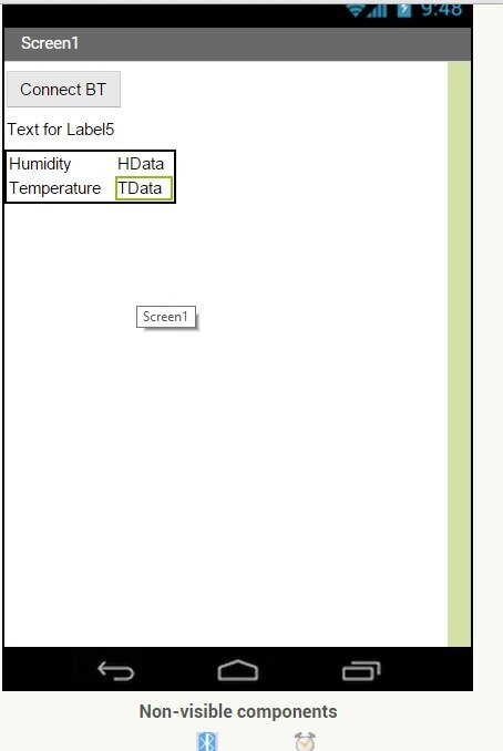

    Sir Neil .... I need help i cant separate the data for humidity and temperature. I want my label3 = Hdata and label4=Tdata image when i run this code humidity and temperature data will display in label3 only image

    neilk over 11 years ago in reply to e14 Contributor
    Hi vdp1331
    I'm sorry you are having trouble with this image. The thread now has so many strands to it, it can be very difficult to follow even for me!
    First of all, my original posting was intended to transmit a single item of data - a number, or a string of text to the Android device.
    The solution you have been following,  by Kovacs Lajos, is sending 2 numeric data items as a concatenated text string - in fact sort of .csv data. Why his phone needs the leading comma, I don't know - I get the same error as you if I try his code.
    So if you are only wanting to transmit a single data item, my original solution should work, but maybe not out of the box - sorry!
    I'm pretty sure that the problem you have is probably caused by the transmit and receive both running at the same nominal delay - ie 1000mS. This results in the Android buffer sometimes containing 2 transmissions from the Arduino.
    I get the problem sometimes, but not very often!
    However, if you reduce the clock/timer time in the App Inventor from 1000mS to 950mS, while leaving the delay in the Arduino at 1000mS, that should fix it. If not, try reducing it to 900mS.
    Hope this helps
    Neil
