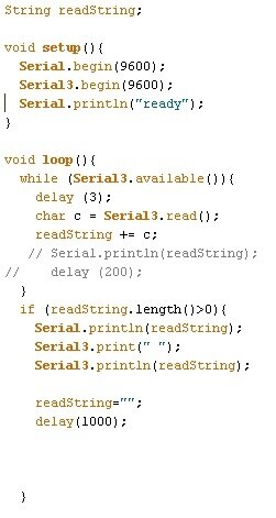

    Hey everybody... Could You Do Me a Favour? I got problem here when I'm trying to make android app using AppInventor2. I'm going to make android app to showed data "TempValue", "MoistureValue", "ldrvalue…
    neil i can solved my problem, i'm adding Serial3.print(" "); in my arduino program and use your arduino system
    thanks for that
    neil i have new problem, to print the string i must click button twice, after that string printed in my aplication
    can you help me, to make print string just once click? using the system above

    Hi tyas.partogi
    OK, I only have Arduino Uno and Nano, so I can't use any other hardware serial interfaces.
    When I connect the Bluetooth to the hardware serial interface on a Nano and use the following code:
    // receive data on serial port and display on serial monitor
    // used to test Bluetooth connection
    // Neil Kenyon 18 Feb 2015
    String myString = "";
    void setup()
      Serial.begin(9600);
    void loop()
      while (Serial.available())              // Read while there are available characters
        delay(3);
        char c = Serial.read();
        myString += c;                        // build the data string
      if (myString.length() > 0)              //If we have a data string
         Serial.println(myString);               // Output the full data string
      myString = "";
    and the Android app with the delay, as I described above, I get the same as you !
    However, if I increase the clock TimerInterval from 100mSec to 200mSec, it works perfectly - at least for me!
    Sorry, I should have mentioned that you might need to increase the TimerInterval in my earlier post.
    I see no reason why thus shouldn't work with Serial3
    I hope this fixes it for you. image
    Neil
    e14 Contributor over 11 years ago in reply to neilk
    neil, it's work!image
    the trouble from my smartphone, I use the application in another phone and it's work
    thanks for your help neil!
