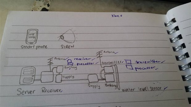

    can i connect my arduino to android via my own app ( project)__ flood alert
    1. app must be downloaded from play store
    2. send and receive data must use internet
    3. target 200 persons
    4. app for read water level in app connected to internet.
    5. app can trigger alarm if safety water level is exceeded.
                                      looks more like this....
    pls help me... tqimage

    neilk over 11 years ago in reply to e14 Contributor
    harekumarbilla@yahoo.com.my Hi . This looks like a pretty complex project, outside of the scope of this thread. Please can you post  as a new QUESTION in the Arduino section of the forum.
    I suggest that you should also explain which parts of the project you have already got working.
    Thanks
