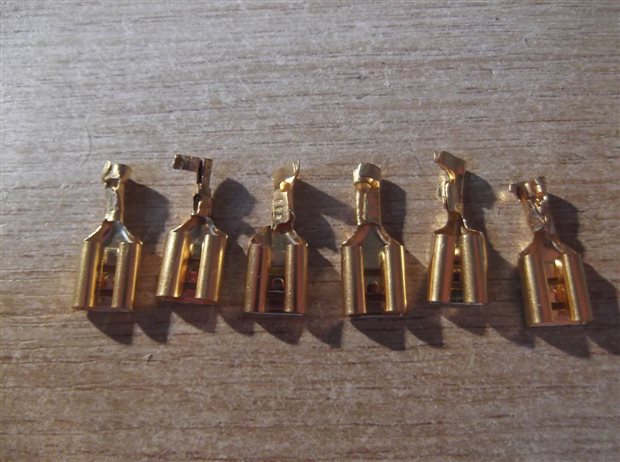

For my Sand Based Cat Detector (Cat Detector Using Sand #2 : The Implementation ) I used a lead acid battery with spade connections. I have never properly used spade connections before (I usually use crocodile clips or solder directly) so I thought this would be a good time to start as I am working my way towards an outdoor mobile robot and robust and reliable connections are essential. Not really knowing much about making spade or crimping connections I decide that the best approach would be to buy some and just try it out. I have wanted to crimp for some time so rather than find out about it I just blundered in and bought something. I do not expect to do much crimping in the future so just looked online and bought the cheapest set I could find that seemed to do what I wanted.
I used deep learning to update my natural neural networks in my head, basically I just stuck some wire inside the crimpets (or connectors) and tried to make good connections with the wire using the crimping tool. Initially there was little success as the tool I obtained did not come with any instructions what-so-ever. The crimpets would not stay on the wire while I attempted to use the crimping tool and several crimpets were harmed in this process.
It took me several attempts to work out that the tool I had purchased did not do any folding of the little tabs on the crimpets. Once I had worked this out and folded over the ;little tabs using some pin nosed pliers I was able to make some good crimped connections. I'm not sure if it uses cold-welding or just mechanical interference to make a good physical and electrical connection, but they seem to work, so all is good.

    Hi Adrian, Probably everyone has their own recommendations, I've been quite impressed with the Multicomp HT-xxx range, I have several of them, they are about $25 ballpark. The HT-230 crimp tool HT-230…
    shabaz over 6 years ago +7
    Hi Dubbie, I do the same as Doug, i.e. add some solder (after crimping) if the specific crimp tool isn't suitable. However, I think maybe your tool might do both the bare wire crimping and the insulation…
    dougw over 6 years ago +5
    There is a lot of science behind good crimp connections. I suspect they rely on the wire bring more springy than the crimp terminal, so after a crimp there is always force on the joint Whenever I don't…

    ... since the motion the two die halves take to mate, is asymmetrical I think (it's a complex motion so I'm not sure, I'm just guessing).
    The motion is  asymetrical to make the power vector as vertical as possible; to "push down" on the connector.
