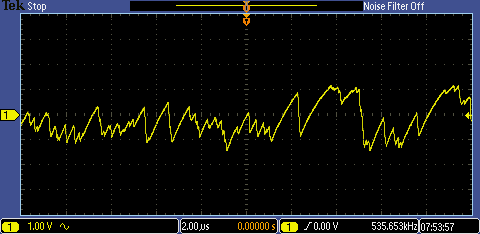

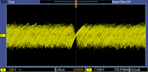

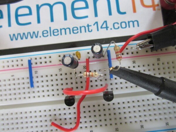

I've just been playing with a very simple noise generator and that's the result.
The digital phosphor of the oscilloscope presents multiple traces of the waveform as though it were sketched with a pencil or crayon.

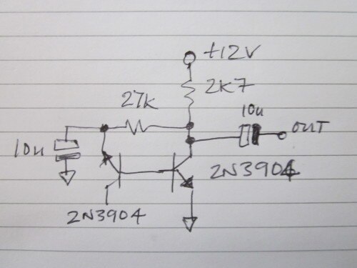

In case it's of any interest, here's the circuit:
The internet is full of variations, with either a Zener, reverse-biased LED, or reverse-biased base-emitter junction as the avalanche 'noise diode'.
For these traces I used a reverse-biased base-emitter junction (the transistor on the left with two pins connected - the other transistor is working as a common-emitter amplifier)
and it produced a very good level of noise out on a 12V supply.

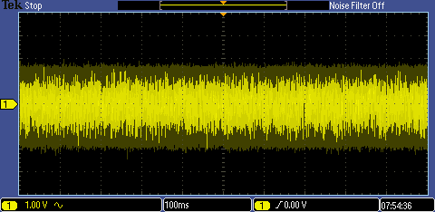

At lower frequencies (the scope is AC-coupled for these), the noise looks quite noise-like. Like this:
but if I go back to the start and show you a single trace of the first waveform, we see this
so we're now looking at a time scale where we can see the avalanching stopping and starting.

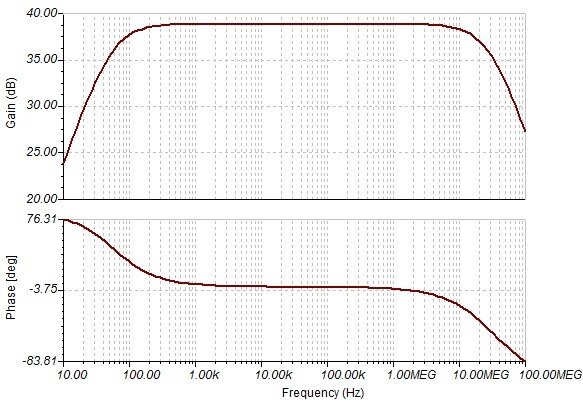

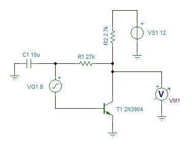

1. The original circuit that I copied had an integrator (low-pass filter) in the feedback of the common-emitter stage
[the 27k and the 10uF] to set the DC bias voltage. That means that the resulting overall transfer characteristic will
be high-pass [the inverse]. I should have considered that a bit more at the time. If I simulate it with this following
circuit (I've substituted a simple signal generator, with an 8V DC offset on it, for the 'noise diode' which is the input to the circuit)
I get this for the response
That won't be entirely right - the simulation is small-signal and the generator is working large-signal - but it lets us
see in a rough way what's happening and understand it in general terms. It falls off from a few hundred Hertz downwards.
That means I'm going to see very little of the low frequency noise as the circuit will integrate it away. Indeed, if I had wanted
to use the generator circuit for audio, it would probably have been better if I had moved the low end cut-off down by
another decade [100uF might do instead of the 10uF].
At the top end, that plot shows quite nicely that the response is determined largely by the amplifier transistor running
out of steam and that will depend to some extent on the individual transistor.

    Have a look at this link from Maxim: Building a Low-Cost White-Noise Generator (maximintegrated.com)  Is the SA used in the Maxim link unable to do analysis at low frequency along the line of reasoning that Shabaz described?
    Sorry, forgot to come back and reply to the question.
    In that particular case, the reason that there's no low-frequency noise is the AC coupling between the amplifiers. The 470pF coupling capacitor and the 50 Ohm input impedance of the amplifier result in a high pass filter.
  • jc2048
    jc2048 over 5 years ago in reply to fmilburn
    The reason I was curious about the transistor is that Navadeep Ganesh U was using a BC547 (fT probably something similar to 2N3904, but beta much higher).
    The low frequency spectra is interesting. The circuit naturally rolls off at the low end from about 100Hz downwards because of the integrator in the bias feedback. If the noise were perfectly white, then it should simply show us the amplifier response at the output - the noise multiplied by the gain. (Qualification: that assumes linearity, which won't quite be the case here because the output signal hardly qualifies as 'small signal'.) But it doesn't - it's more or less flat from 100Hz down.
    The noise book I've got says that avalanche diodes suffer from more excess noise [it's contrasting them with diodes where the Zener effect dominates and which are, therefore, better if you want a low-noise reference]. Excess noise is over and above the white noise and is generally l/f (low-frequency) noise. It will cause the overall noise to rise as the frequency falls. I was wondering whether we might see that.
    These are the two FFT traces I was having difficulty with.
    This first is AC coupled and seems to show a very low level of noise and the response looks to be the amplifier response, rolling off below 100Hz. That's with the noise filter quite close to the Nyquist rate for the FFT [too close?].
    This next is DC coupled with the offset removed, which seems to result in a much higher level of signal and the noise actually increasing from 100Hz down. This time the filter is further up, so is aliasing posing a problem?
    Neither is the result you've just got.
