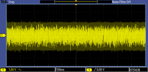

I've just been playing with a very simple noise generator and that's the result.
The digital phosphor of the oscilloscope presents multiple traces of the waveform as though it were sketched with a pencil or crayon.

At lower frequencies (the scope is AC-coupled for these), the noise looks quite noise-like. Like this:
but if I go back to the start and show you a single trace of the first waveform, we see this
so we're now looking at a time scale where we can see the avalanching stopping and starting.

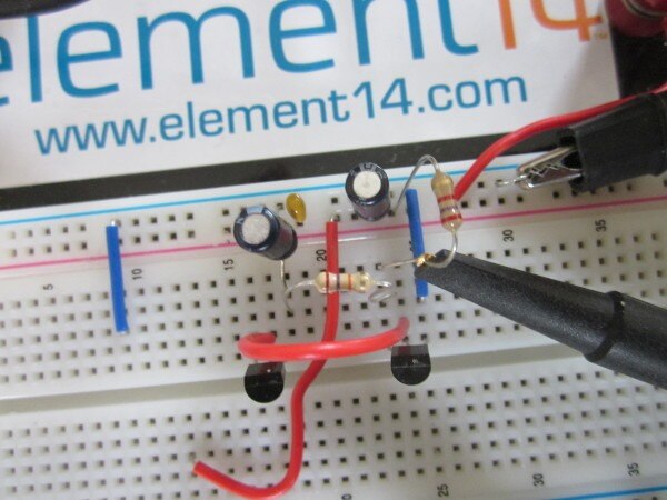

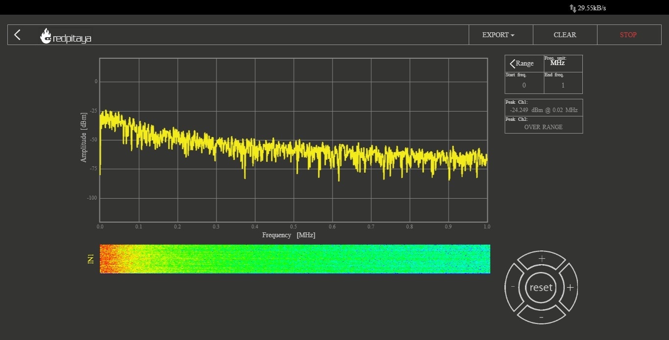

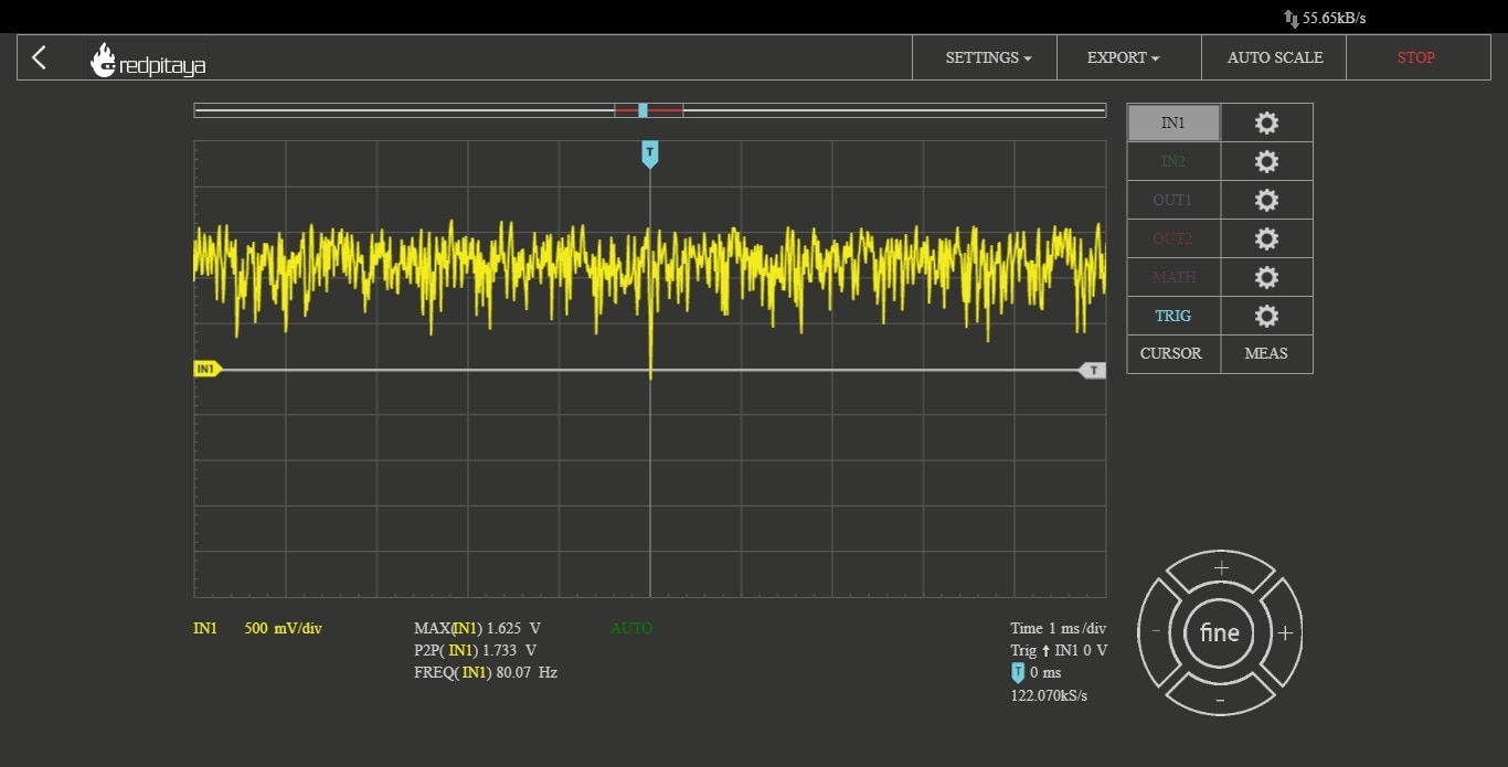

    I tried it with BC547 and 4.7K,47K and boom, there is the noise generated. It starts coming after exact 12V and I like the way it works. At the output, starts at 0V, slowly rises, and when input is 12V, noise starts generating and the voltage level settles down. When turned off, the capacitor takes it full negative and slowly comes up to 0 at full discharge. Btw, this is the first circuit I am trying with the new RedPitaya scope!
  • jc2048
    jc2048 over 5 years ago in reply to navadeepganeshu
    Your RedPitaya looks an interesting piece of kit. Can you use it as a spectrum analyser to look at how the noise is distributed in the frequency domain?

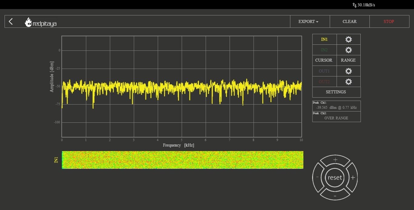

    fmilburn over 5 years ago in reply to shabaz

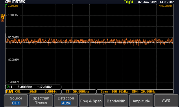

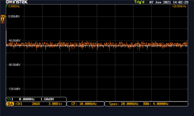

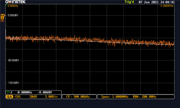

    Here is the icing image
    Below is 0 to 20kHz span with RBW = 4Hz!  White trace is 256 SA averaged.
    I overlaid the horizontal cursor on 0 to 100kHz shown below and saw no deviation from flat.  Cursor not shown in screenshot below.
    Droop is evident 0 to 1MHz
  • jc2048
    jc2048 over 5 years ago in reply to fmilburn
    Thanks for showing us the spectra. It's interesting seeing what an instrument that operates more like a traditional SA makes of it.
    If I set my 'scope to have a long persistence, it shows me the envelope of the response better.
    This plot is 0 to 2.5MHz, so centre is 1.25MHz. It shows the amplifier roll-off from about 250kHz, which isn't too much different to yours, so it's encouraging that I'm viewing something sensible.
    What type of transistor were you using?
    I'm much more confused about the other end of the scale in the region from a few hundred Hz downwards. I can get radically different results, depending on the settings I use and how I make the measurement. Would you be able to do a trace with a span of 1kHz and a centre of 500Hz?
  • fmilburn
    fmilburn over 5 years ago in reply to jc2048
    I am using 2N3904 transistor.  Below is the trace with 1kHz span and center 500Hz.
    I twiddled knobs in FFT mode and move the horizontal start to better match your FFT view above and  got this:

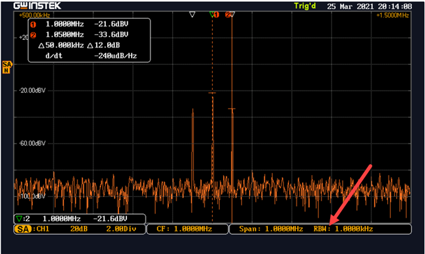

    I don't understand what magic is involved.  Have a look at this link from Maxim: Building a Low-Cost White-Noise Generator (maximintegrated.com)  Is the SA used in the Maxim link unable to do analysis at low frequency along the line of reasoning that Shabaz described?

    The reason I was curious about the transistor is that Navadeep Ganesh U was using a BC547 (fT probably something similar to 2N3904, but beta much higher).
    The low frequency spectra is interesting. The circuit naturally rolls off at the low end from about 100Hz downwards because of the integrator in the bias feedback. If the noise were perfectly white, then it should simply show us the amplifier response at the output - the noise multiplied by the gain. (Qualification: that assumes linearity, which won't quite be the case here because the output signal hardly qualifies as 'small signal'.) But it doesn't - it's more or less flat from 100Hz down.
    The noise book I've got says that avalanche diodes suffer from more excess noise [it's contrasting them with diodes where the Zener effect dominates and which are, therefore, better if you want a low-noise reference]. Excess noise is over and above the white noise and is generally l/f (low-frequency) noise. It will cause the overall noise to rise as the frequency falls. I was wondering whether we might see that.
    Sorry, forgot to come back and reply to the question.
    In that particular case, the reason that there's no low-frequency noise is the AC coupling between the amplifiers. The 470pF coupling capacitor and the 50 Ohm input impedance of the amplifier result in a high pass filter.
