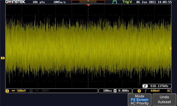

I've just been playing with a very simple noise generator and that's the result.
The digital phosphor of the oscilloscope presents multiple traces of the waveform as though it were sketched with a pencil or crayon.

At lower frequencies (the scope is AC-coupled for these), the noise looks quite noise-like. Like this:

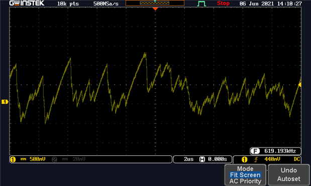

but if I go back to the start and show you a single trace of the first waveform, we see this
so we're now looking at a time scale where we can see the avalanching stopping and starting.

    For comparison to Jon's original post, here is 100ms followed by a screen grab at 2us.

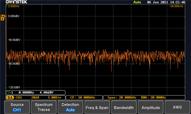

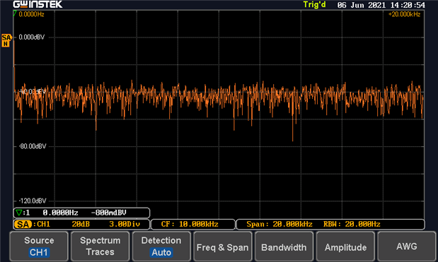

    Now a look at the spectrum analyzer view.  The center frequency is 10kHz with a span of 20kHz.  RBW is 20Hz.  Circuit supply voltage is 12V.
    Below the circuit supply voltage is reduced to 6V to get an idea of the floor and there is about a 20dBV drop.

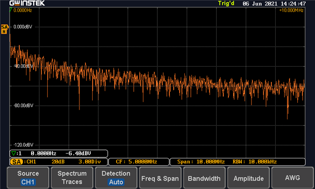

    Now the span is set 0 to 10MHz, showing the droop with frequency.

    Here is the icing image
    Below is 0 to 20kHz span with RBW = 4Hz!  White trace is 256 SA averaged.
    I overlaid the horizontal cursor on 0 to 100kHz shown below and saw no deviation from flat.  Cursor not shown in screenshot below.
    Droop is evident 0 to 1MHz

    If I set my 'scope to have a long persistence, it shows me the envelope of the response better.
    This plot is 0 to 2.5MHz, so centre is 1.25MHz. It shows the amplifier roll-off from about 250kHz, which isn't too much different to yours, so it's encouraging that I'm viewing something sensible.
