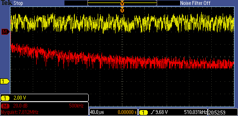

I've just been playing with a very simple noise generator and that's the result.
The digital phosphor of the oscilloscope presents multiple traces of the waveform as though it were sketched with a pencil or crayon.

At lower frequencies (the scope is AC-coupled for these), the noise looks quite noise-like. Like this:
but if I go back to the start and show you a single trace of the first waveform, we see this
so we're now looking at a time scale where we can see the avalanching stopping and starting.

    jc2048 over 5 years ago in reply to michaelwylie
    This is the low end [10 seconds]
    This is the top end where the gain is rolling off
    Both of these are dc coupled.
    My 'scope is just an old MSO2022B. The FFT isn't all that easy to use and I'm not sure how much I'd trust it.
    It's per division. The low frequency one is fairly meaningless because of all the aliasing from signal components above the Nyquist limit set for the FFT.
    If I enable the noise filter at its lowest setting of 60Hz, we get this
    which shows us better the artefacts from the resampling of the FFT because we see the interaction with the filtering.
    As a way of looking at a low frequencies it's all seems a bit useless (not helped by my own uselessness and lack of understanding, which I'm proudly displaying for all to see!).
    Could I be doing this better, or is this simply the limits of what you can do with FFT on a [moderately] cheap 'scope?
    I suppose the best approach to seeing the low frequency end would be to physically filter, before giving it to the oscilloscope.

  • jc2048
    jc2048 over 5 years ago in reply to shabaz
    I had assumed that a more expensive oscilloscope would do it better.
    If I use the 'noise filter' alone, I see this for various filter cut-off frequencies [I missed 1.4kHz, but you get the general idea]
    The noise from the circuit declines as the frequency comes down, and in the area Michael was interested in there looks to be very little at all [practically all aliasing and no actual signal!]. Some [all?] of that is going to be down to the electrolytic that's holding the average bias voltage that the 'noise diode' is then working against to drive the base of the amplifier transistor. As a circuit, it's not looking too good for producing white noise.
