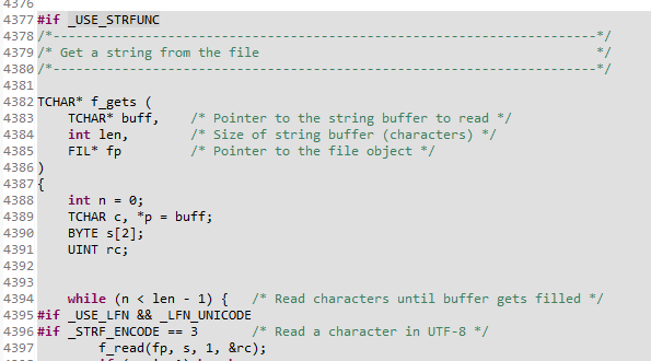

Enable the String Write Functionality
When you look at the source of the default download of the FatFS library, you'll see that the string functions are grayed out (see screen capture below).
That's because the lib is configured that way. If you check the ffconf.h file, you'll find this line of code:
#define    _USE_STRFUNC    0
/* This option switches string functions, f_gets(), f_putc(), f_puts() and
/  f_printf().
/  0: Disable string functions.
/  1: Enable without LF-CRLF conversion.
/  2: Enable with LF-CRLF conversion. */
By changing this to:
#define    _USE_STRFUNC    1
we have access to the string functions.
