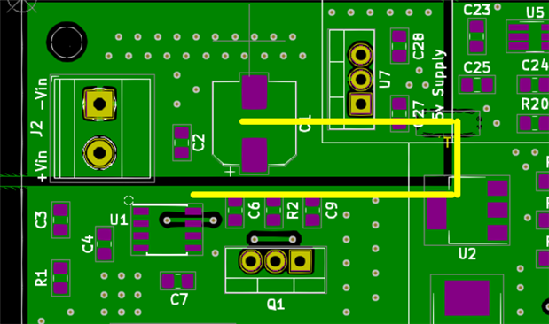

    • The feedback circuit: I’m no stick in the mud - if a common refrain is “something up with the feedback?” from you and Shabaz (and a couple of other people who haven’t even seen the circuit) I think that perhaps there is indeed “something up with the feedback”!
    • The ground plane: I think I’ve got this hideously wrong and I’m coupling noise from the switching circuit into the rest of the control circuit.  This is just something I was thinking about and have been researching.
    I thought I understood what the feedback circuit is doing but I've been mulling over the data sheets again and in trying to articulate it here, it doesn't add up in my head - I can't see how it operates to reach the 1.7v difference, sorry.  Essentially, it is 'programming' a different output voltage for the LTC1624 as the load voltage changes.  I had thought the two 100K resistors were providing a voltage to the PNP transistor approximately half way between the output voltage from the inductor (switching circuit) and the load voltage.  The 1K resistor is reducing the voltage from the inductor to just enough to turn the PNP on and allow enough of a current to flow over the 5K resistor to tune the voltage to the feedback pin.  That is being internally referenced to balance the output of the LTC1624 such that it adjusts the current to the Inductor so it remains in balance with the output current.  That naturally adjusts the voltage to allow for that balance to occur.  I guess I took it for granted because looking at the simulation in more detail, I can't work the maths out,
    If I look at the ground plane I have - first image is bottom layer with silk screen; second is the top layer - I kept the power ground separate (as the datasheet said) but I'm thinking that the way I've laid this out is contributing to the problem.  You can see where the net tie is (circled), so path to ground for the switching circuitry is underneath the rest of the control circuitry but is also mixed on the top layer as well.
    I'm now thinking I should have done the following (replicated on the top layer), and tying in multiple places:

    shabaz over 7 years ago in reply to Andrew J
    Hi Andrew,
    You're right, that top-left quadrant of the board (i.e. power entry) should have its ground plane linked directly to the switching regulator portion below, because currently there's a long path for any input capacitance for the switching regulator. That's an easy fix, by scraping off some solder resist and patching it with wire.
    Regarding Rsense, this is for limiting current - I think you're ok with the low resistance you have; a higher value may accidentally cause the chip to think the output is being overloaded.
    The step-down converter tracking is a nice idea, but definitely complicated : ) Anyway I just wanted to say, I hope you stick with it, because you're close to getting a good design, and large chunks are functioning. This first PCB is really still part of the design iteration, and the place to measure/experiment as you're already doing.
    In terms of PCB layout, it's a lot better than some. Generally it's good. Once you've decided on the areas that need separate planes, it gets hard to follow them if there are too many traces on it, so it's good to make the underside have almost zero traces, or very short length traces, to reduce the risk of breaking the plane too much. The top plane then just becomes an accoutrement, and not necessary, apart from providing some copper fill. Due to the complexity, your design does have lots of broken ground plane on the right side, but sometimes it can't be helped.
    Also, it's great that your design has many interesting features like the on-board diagnostics from the thermistors, and the nice user interface. It's always cool to try new things : ) When experimenting with PSU ideas, I liked the idea of an electronic fuse, or other similar algorithms.. I would find that more useful than traditional current limiting, but maybe I'm unconventional : (
    Hi Andrew,
    For the switching regulator (step-down converter), the input capacitors are very distant:
    Although the positive terminal of the capacitors (C1 and C2) are close, the negative terminal has to take the yellow route, which looks >50mm if I try to measure the line. The solution (on your current PCB) is to either add another capacitor closer across pins 8 and 4 (Vin and Gnd), or scrape some solder resist off and provide a wire bridge across the shortest distance between the two plane regions.
    I don't know if it is having a noticeable impact, but it would be good to eliminate it, because this distance is about 5 times more than what is achievable (it is possible to have a capacitor within millimetres of the pin) for a path that will have high frequency high current flowing.
    For the probing, is the probe on the X10 setting? (some probes are still made with X1 setting, so just double-checking). Soldering a short wire, and putting on a socket (e.g. jumper socket, or a socket intended for a D-type connector shell could be an option (depending on probe tip diameter).
  • Andrew J
    Andrew J over 7 years ago in reply to shabaz
    Yes, really those should have been on the SR ground plane - as I say, I got it hideously wrong.  I'll be soldering a wire across tomorrow and testing.
    I use the probe in 10x full bandwidth when probing DC voltages; 1x 20mHz bandwidth when measuring AC noise.  I'll give soldering a wire a go if I need to start probing around U1/Q1/R2 because the PCB can't afford another desolder/solder cycle of Q1 or R2.
