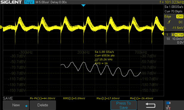

Noise and Ripple Testing
Noise and ripple are poor which I need to sort out.  For the sake of documenting the testing, I’ve included images below to show what I mean.

Supply on at 15v.  Timebase and/or voltage division selected to show noise; bandwidth limited; 1x probe, AC coupled.
10 Ohm Load attached, powered through RCD (1st image), no RCD (2nd Image):
No load attached, powered through RCD (1st image), no RCD (2nd Image):
And here's a couple with the timebase changed, both without RCD.  With load (1st image) and no load (2nd image):
I think it's fair to say these are NOT good results and I need to do something about it.  Again, I suspect the MOSFET.

    Some interesting test results you have shared with us. Some of my thoughts..... Did you measure what the voltage was at the rectifier with the 5Ohm resistor attached, are you dropping volts there that…

    jc2048 over 7 years ago +4
    Hello Andrew, Having now looked at your schematic and their design article [I'm doing this all backwards!], here are a few quick observations. In the context of their circuit (I found your schematic confusing…
  • Andrew J
    Andrew J over 7 years ago

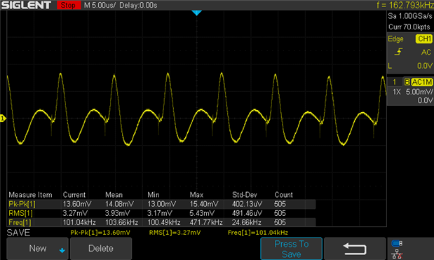

    I've made the change to the ground connections as suggested - in two places actually:
    This has improved things somewhat.  First image, before change; second image after change:
    Pk-pk has reduced a lot, although still not acceptable.  The actual switching spike (at the point of the max rise) is measurable at 4.3mV and the waveform is more sinusoidal.  I took the 4Duino and thermistors off the board and re-measured:
    A little more difference in the pk-pk and a cleaner waveform.

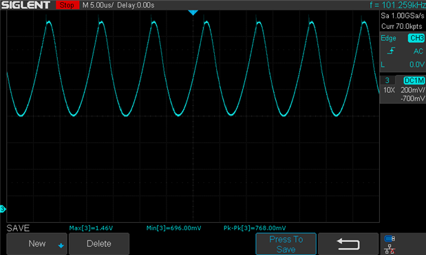

    I also measured the feedback voltage with 10Ohm load:
    According to the data sheet, the LTC1624 should be able reach 200kHz with a feedback voltage of 0.75V; with a 0.696V minimum it should be getting close to 200kHz.

    I did some measurements with the 5Ohm load as well:
    Feedback voltage:
    Here we have a minimum value of 0.460V - enough for 170kHz.

    With the 5Ohm load attached, the Vfb pin is seeing a peak of 2.16V and at 10Ohm it is 1.46V: it is rated for an absolute max of 2.7V to -0.3V so it's within range.  The range given in electrical characteristics is quite tight actually, 1.1781V - 1.2019V, and is tested "...in a feedback loop which servos Vfb to the midpoint of the error amplifier (Vith = 1.8V)  Measuring Vith with the 5Ohm load, it is giving a voltage of 1.18V to 2.14V  (nominal range is 1.19V to 2.4V); with the 10Ohm load it is 1.6V to 2.34V.
    The datasheet actually says: "...The main control loop is shutdown by pulling the Ith/Run pin below its 1.19V clamp voltage..." so it could be unstable for the 5 Ohm load, hence the low voltage.
