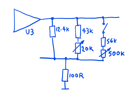

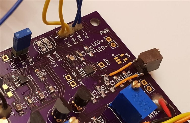

    shabaz over 7 years ago in reply to fmilburn
    Hi Frank,
    Problem solved (I think) : )
    Somewhere along the line the tolerance of the LM334 was missed, we probably both assumed it was absorbed into the calculations once we'd created the spreadsheets, or that it would be trimmed out by the existing trimmer circuit, and didn't examine the datasheet again. But, although it is stable, it might not be at 10mA. Although it can be adjusted out, really two resistances need to be trimmed for 10mA, and two for 1mA, otherwise the temperature compensation will get affected : (
    Here's an alternative suggestion, and it seems to work.. basically, instead of trimming current to 10mA, the gain of the amplifier could be trimmed instead. I think we don't need the current source trimmers at all, since it seems to be stable with no adjustment. So, no more trimmers are needed, but they are instead used for amplifier gain adjustment (plus this is better for the future too, since if it is ever modified for ADC, then zero trimmers are needed since the measured value can be multiplied by the microcontroller).
    Since there are two ranges, that means that amplifier trimming also needs to be switched along with the range. But that's ok, it is possible to do it with a normal DPDT switch with one pole selecting the current source, and the other pole switching in the second trimmer. It means the second current source should be changed from 1mA nominal, to (say) 1.1mA, because then it's easier to have such a trimming mechanism without more switch poles.
    The mod below shows the idea.. the 20k trimmer is used to adjust the reading for the 10mA current source. Then, the switch (one half of the DPDT switch) is closed, and the 500k trimmer is used to adjust for the 1.1mA current source. The values were chosen so that a +-3% gain adjustment can be made via the trimmers, for both ranges. The 10mA gain adjustment has to be trimmed first with this topology, since the 20k trimmer is never switched out. The 500k trimmer will work regardless if the 20k trimmer is set at any extreme, if the current source is designed for 1.1mA +-3%.
    I don't have a 500k trimmer, so I just tested the 20k trimmer, and the measurements are spot on for 116mohm, and 14mohm (these are the only two values I tested so far) with sub-milliohm error. Since both of my current sources have approximately the same proportion error, I actually don't need the 500k trimmer switched in if I keep the second current source at 1mA instead of 1.1mA, but that can't be assumed for all builds of course!
    This is what my build looks like currently, i.e. just the 20k trimmer mod, and no switching since the error adjustment happens to be the same across both ranges:
    Maybe for the rev 2 PCB, as well as these new amplifier trimmers, the existing trimmer locations are kept, but are set to do-not-fit for now, since all seems stable without them.
    Here are the values for the 10mA and 1.1mA current sources:
    10mA: use -1.85mV/degC and Vf=0.7199
    top resistor network to equal 17.7931ohm, which is 33.2 ohm paralleled with 38.3 ohm
    lower resistor network to equal 127.2167 ohms which is 160 ohm in parallel with 620 ohm
    1.1mA: use -2.01mV/degC and Vf=0.660V
    top resistor network to equal 145.8354ohm which is three resistors, 150 ohm, 5.6k and 82k all in parallel
    lower resistor network to equal 1145.483 ohms which is 1.33k in paralled with 8.2k
    With the current schematic, R7 and R22 and trimmers R8 and R23 would become DNP.
    I'm going to box it all up now, see if it still functions : )
