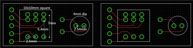

    I'm not sure I understand the following:
    If you're going to spin a new board sometime, I've got a few (minor) suggestions, such as having a DPDT switch and LED on part of the PCB that people could chop off..
    We could use mouse bites to separate the PCB cleanly from the main board but what footprints for the DPDT and LED?
    I seem to remember that you had tried using KiCad at some point.  If you like, I can send you the raw files after doing the mods so you can tweak them further if needed.
    Frank

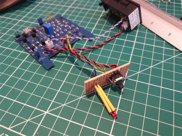

    shabaz over 6 years ago in reply to fmilburn
    Hi Frank,
    I didn't travel beyond a single resistor and capacitor, unfortunately I still need to learn KiCAD one day.
    This is how I've wired the range button and out-of-range LED currently (I left the wires long on the LED, since I can bend/fold them behind the front panel, to position it to the right depth to match whatever the cap height ends up being after the button cap is attached. These push on/push off buttons are nice because they can accept a circular cap, and circle is easier to cut instead of a square.
    It was just an idea, if you've got the space, then maybe two areas like this could be be implemented, this is just a rough sketch, to accept a push-button and a 3mm LED. All holes are 1mm dia.
    The PCB design you've currently got has got to protruding pieces which could be removed, since there's no components there, so that that entire side could be cut off with a hacksaw (or mousebites as you say).
    The reason for two add-ons is that one could be for range, and the other could be for on/off, and they could be identical. The user could decide to position them both on the front panel, or optionally place the power on/off on the rear panel.
    For compatible switch, there is MHPS2283 or ESB30B102 either would fit that footprint. Button caps are cheap from Aliexpress.
    Anyway, all this is just optional and could be omitted, since it's not a lot of effort to just solder these bits onto some stripboard.

    Hi Shabaz,
    I made a TO-DO list based on your improvements above plus what I gathered up from some of the other posts scattered about.
    1. Add pads for 0805 resistors (10k) between LSENSE and LCURRENT and also HSENSE and HCURRENT.  This fixes the instability issue.
    2. Add a snap off PCB for the DPDT switch (e.g. MHPS2283 or ESB30B102) and a LED.  This aids in moving the switch and LED to a panel.
    3. Modify the footprint of the trimmers to allow use of Bourn 3299W trimmers.  Label the trimmers HI and LO to indicate which range they trim.
    4. Add pads for 0805 resistor and 0805 capacitor between pins 4 and 5 of the voltage regulator.  This will allow use of the REG101NA-A voltage regulator which can hand higher voltage supply such as 9V battery.
    5. Rename JP1 TEST instead of CAL since it is no longer possible to trim the current source.
    6. Place bypass caps closer to comparator.
    7. See sketch from Shabaz and others in comments of Jan 24th post for ideas on improved layout, especially around amplifier.
