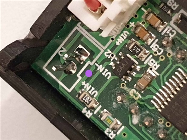

    Meter mod:
    The meter has two white connectors. One connector is for the meter supply voltage to power it up. The other connector is for the measurement input to the meter.
    This modification is required on that measurement related connector.
    Using a pair of pliers or cutters, carefully pull off the white socket as shown in the photo below, which is the meter measurement input connector.
    It will slide off and leave the two pins remaining.
    You can desolder the pins now quite easily, without needing to remove the PCB from the meter enclosure.
    Next, with a knife/scalpel, cut the track indicated with a purple circle in the photo below.

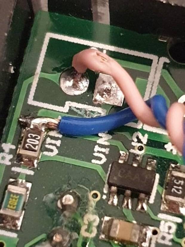

    Solder two wires to act as the meter input in lieu of the previous connector. The positive connection will be the corner pin, same as it was with the connector.
    However the negative connection is to be soldered to the resistor shown in the photo below. By doing this, the input to the meter module becomes a differential input.
    shabaz over 6 years ago
    It was quicker to just photograph the mods:
