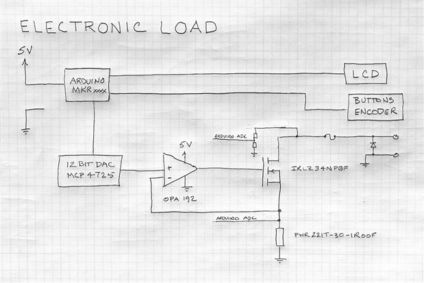

What was on hand is shown in the following schematic:
An Arduino MKR1000 output a voltage using the built-in 10 bit DAC which through an OPA192 op amp and MTP305VL MOSFET control the voltage above the 1 ohm resistor.  One volt output from the MKR1000 equals one amp to the device under test.  In this case the DUT is a 18650 battery hooked up to a boost converter to give roughly 3 Volts.
I was surprised at how good the DAC was on the MKR1000.  The MKR1000 ADC had an offset of around 18 mV.  Not shown on the schematic above are digital multimeters measuring the input voltage from the DUT, the output voltage from the DAC, and the voltage across the 1 ohm resistor.  Tests were run at 10 mA, 50 mA, 100 mA, and 1000 mA where it was discovered that the voltage output of the DUT was dropping quickly.

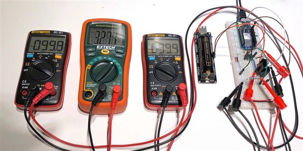

Results
10 mA
DAC output: 10.9 mA
DUT voltage: 3.295 V
Current: 11 mA
Error: 1 mA
50 mA
DAC output: 49.1 mV
DUT voltage: 3.289 V
Current: 49.1 mA
Error: 0.9 mA
100 mA
DAC output: 99.8 mV
DUT voltage: 3.271 V
Current: 99.1 mA
Error: 0.9 mA
1000 mA
DAC output: 997.5 mV
DUT voltage: 2.89 V
Current: 997.2 mA
Error: 2.8 mA

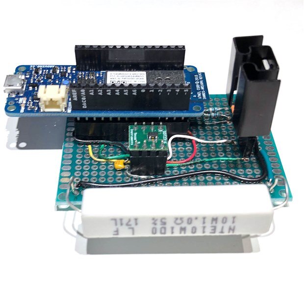

8 July 19 Update
I soldered a little protoboard to play with before deciding what to do next.  The idea was to make something more reliable mechanically and allow some thermal testing and firmware development.  The design still uses the DAC on the Arduino MKR1000 , OPA192 op amp and the MTP3055VLMTP3055VL MOSFET.  The one ohm resistor was picked up cheap locally and measures 1.003 ohms using the milliohm meter.
Female headers were soldered in so that the parts can be easily removed and reused in future.

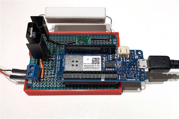

Here it is populated.
If you have a 3D printer, then you have to print stuff.  Here it is in a little tray.
After fixing a wiring mistake where I confused pin 5 on the op amp with pin 5 on the carrier board (pin 5 on the op amp leads to pin 6 on the carrier) everything was working.  There seems to be an intermittent bad connection between 5V on the MKR1000 and the op amp - one of the main reasons the board was constructed was to avoid this!.  The DAC is accurate in the range tested so far as is A1 which measures the input voltage.  A2 which measures the voltage (and thus current) just above the resistor has about 17 mV offset which seems high but I should consult the datasheet to see if it is in spec.  It can be corrected in firmware.

    Received these parts which more or less match the 2nd schematic drawn above:
    • Bourns PWR220T-35-1R00FBourns PWR220T-35-1R00F TO-220 style 1% 1 ohm resistors
    • IRLZ34NPBFIRLZ34NPBF Infineon N-Ch MOSFET
    • MCP4725A0T-E/CHMCP4725A0T-E/CH Microchip 12 Bit DAC
    • OPA192IDBVROPA192IDBVR Texas Instruments Op Amp
