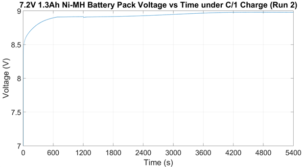

Second Charge
After that discharge run, I was hoping to charge the pack at a more rapid C/1 rate to observe a negative delta-V indication of full charge.
Unfortunately, having the voltage limit on the supply set to 9V, the pack became voltage-limited during charging likely due to high internal resistance. A look at the individual cells shows the healthy cells doing just fine, with Cell 2 reaching full charge early. Cell 4, however, due to its high internal resistance, ended up “soaking” up a lot of voltage initially, reaching close to 2V which may have caused further damage to the cell and unexpected chemical reactions. This is why for certain sensitive chemistries (e.g. Li-based), balancing series cells is mandatory.
That being said, the B&K Precision/Sefram DAS240-BAT proved its value in being able to monitor per-cell performance of a battery pack thanks to its isolated channels. The CAT I 100V rating does limit the size of battery packs it can be used with, however.
