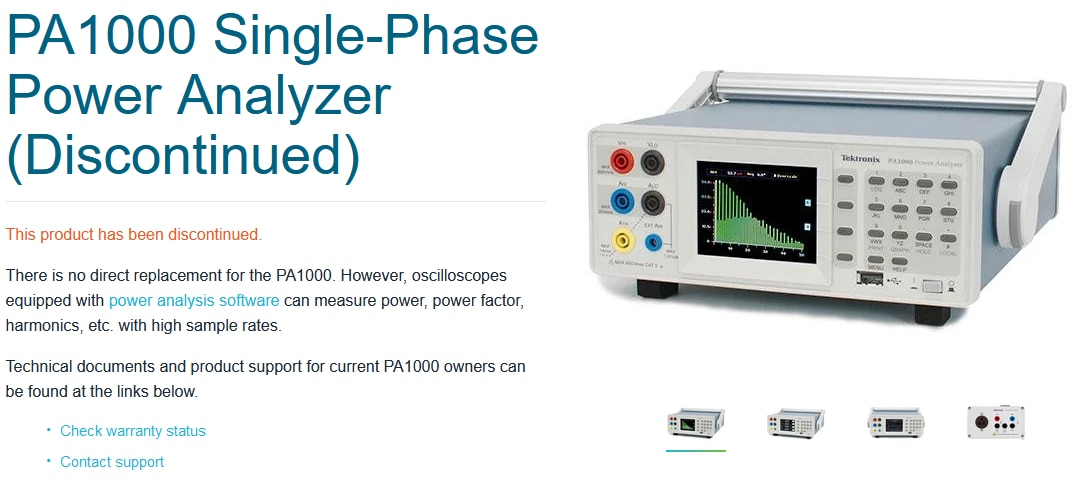

At this time, I was also checking out the Tektronix PA1000 to see if there had been any developments there since my review. It seems not to have had any firmware upgrades since my review, with the software stagnating not long after with a few compatibility issues with later versions of Windows. That is why I still had a Windows 7 machine, later a VM, dedicated to running PwrView to ensure I still had access to the IEC Standby Power Test which is its "killer application".
Unfortunately, the product page bought be some bad, although not unexpected, news. Tektronix has quietly discontinued the PA1000 and PA3000, both formerly Voltech products. It seems the discontinuation also caught others by surprise, by its quietness.
I have a feeling that the power analyser is probably not a market segment which sells in large volumes, but selling oscilloscopes with power analysis software options and relatively expensive probes is likely a more fruitful strategy and may actually be more profitable. Users can analyse cycle-by-cycle events much in the way an oscilloscope resolves the time-domain down to nano-seconds while a digital multimeter does not. However, just as oscilloscopes did not render DMMs obsolete, I feel that an oscilloscope-based solution has some potential downsides - expense, complexity of set-up and potential accuracy issues with low standby currents depending on how it is probed. Perhaps it's a sign of the times, as I also noticed the Rohde & Schwarz HMC8015 Power Analyzer also being discontinued, although Hioki and Yokogawa (amongst others) still seem to be in the market.
For all its quirkiness, I've grown to get along with the PA1000 so I will probably keep using it for as long as I can. One of the key issues, though, is the PwrView/PwrView64 software which seems to have issues under Windows 10. As I use it over the network, the first step is to add the IP address into the networked instruments panel:

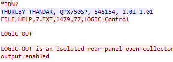

But this had me wondering ... just how does the firmware transfer utility work? Grabbing out Wireshark, I discovered it uses an "undocumented" SCPI command called FILE. Very nice ... but don't use this if you don't want to cause trouble!

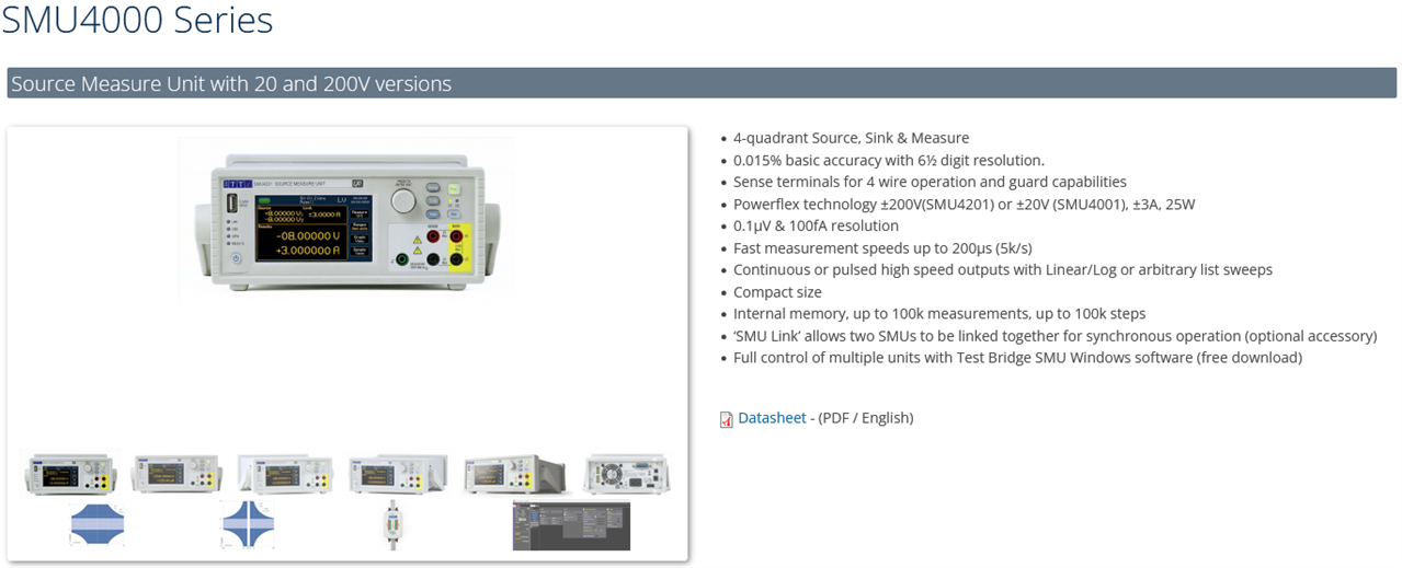

It seems also to be a very interesting time in the test-and-measurement market. Earlier in the year, I reviewed (under loan) a Rohde & Schwarz NGU401 Source Measurement Unit, which is a new entrant in the field ordinarily dominated by Keithleys. The Keysight B2901A/B2902A/B2911A/B2912A were all discontinued on 1st December 2021 at the time, and I didn't know what was happening, mulling that perhaps Keysight would leave the field. But I was ultimately wrong as they have now announced their facelifted black colour-scheme versions under the B2901B/B2902B/B2911B/B2912B/B2901BL/B2910BL model codes. Since Rohde & Schwarz introduced the NGU-series home-grown SMUs, the ADCMT units they previously co-branded have disappeared off their website, although I'd never seen nor used one. While Yokogawa is in the market too, I haven't seen one in-the-flesh and don't feel they're quite as bench-oriented as the others.
Imagine my surprise when I saw this post from markedwards (Director, Aim-TTi Instruments) introducing their SMU4000-series. It is always refreshing to see another entrant into the market - at the moment, the SMU4001 offers +/-20V while the SMU4201 offers +/- 200V but with quasi-constant-power envelope rather than the "rectangular" ranging as is common in most SMUs. It claims to be smaller than most as well, having an A4 footprint and can be linked through an external adapter to form a two-channel unit. It's not quite the 60W monster of the NGU201/401, but with a 25W power rating, it is slightly beefier than the 20W-rated 2450. On the surface, the SMU4201 isn't a bad match for the Keithley 2450 as it offers a fairly similar power and voltage range. Settling time is quoted slower, but the tests may not be under the same conditions. In terms of accuracy, the specifications seem to suggest they are neck-and-neck with the SMU4201 besting the 2450 occasionally, and seemingly offering a lower offset error on many of the ranges.
That is a most interesting development to see - I wonder whether one of those might turn up on RoadTest. But that being said, what sells Keithley SMUs is not only the capability, but the software library and on-device TSP scripting capabilities which are quite powerful. While other vendors do have their own software (in the case of the SMU4000, there is Test Bridge SMU), the quality and support in various use cases will vary. Nevertheless, it seems the SMU4000-series is host-driven similar to the NGU401, but at least it does have a decent 100k onboard reading buffer unlike the NGU201/401 which should make certain time-sensitive tasks (e.g. sweep) easier to handle. Best of all, compared to the 2450, it seems to be notably cheaper - almost by 20%.
