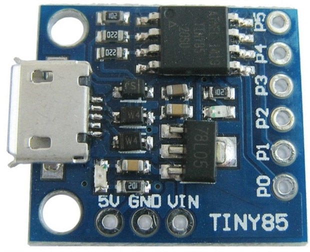

The other week I was playing with a Digispark clone, and it turns out that the suppliers have not programmed them correctly.
Let me explain

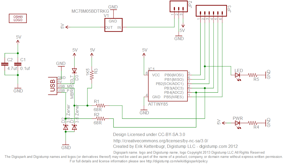

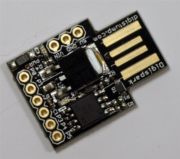

When Erik created the Digispark, he wanted to use all 6 pins of the ATTiny85 for I/O.
Because there is a bootloader, you can program them as per any other Arduino (slight differences but essentally the same), rather than having to use an ISP programmer.
The reset pin has been disabled via the fuse setting, and therefore becomes a normal I/O pin.
The schematic is published here.
https://s3.amazonaws.com/digispark/DigisparkSchematicFinal.pdf
What about the clones
The clones have a micro USB connector, which suited my project, while the proper Digispark have the USB plug as part of the board design.
For my application, I wanted something that you could plug into and hide the cable underneath.
Hence these suited my physical need, but it turns out the electrical spec was something else.

Since two pins are already in use for the USB and are either held high, or dragged down by a 3v6 zener, it meant I needed to be very careful about what was where, which is why that extra pin is so useful.
These clones I purchased have the bootloader programmed, but the reset pin remains as a reset.
The simple test is to program the blink porgram into it, then using a 220 ohm resistor, connect pin P5 to ground, and the blinking will stop for 5 secs, while it restarts.
So the only way to resolve it was to reset the fuses, and program the correct fuse setting to remove the reset pin function.

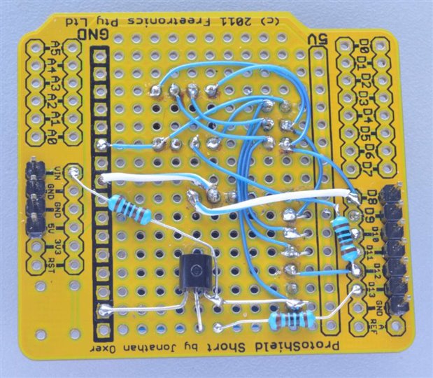

You need some form of micro to drive the pins and control the 12v.
In each of the discussions, they talk about using an external 12v source, and I thought why not just feed the Arduino with 12v via the external input, and use that.
Warning the ATmel chips want 11.5-12.5v only.

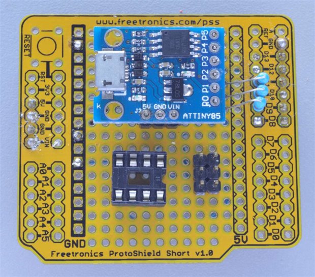

Since I was going to be making some hardware, it seemed only sensible to include a 8pin socket and the normal ISP connections, that way it could be used for other projects.
Protoboard
Freetronics (Australia) make a range of Arduino and a couple of Prototyping boards.
They are great but I do wish they would allow more material around the holes, as soldering to the rails is a bit difficult with the heat loss.
I wired it onto one of their short boards, and starting thinking if I'd started a few months earlier, I could have made a pcb.
Regardless it got wired and I resisted skipping the other bits.
It's not the tidyiest work, and as you can see, a modification was required.
Some eagle eyed readers may ask, "how come the clone board is stting up, what magic does he use".
In order to get a good contact, I chose to use slightly longer header pins, and after the clone was fitted, to bend the pins so that each pin is alternately bent away from straight.
You need to use something to put a little pressure on the pin to straighten it when fitting another board, but it works well for this purpose.
Whats the deal with D12.
When I first tried this it didn't work.
The sketch either hung or gave nulls for the readings, and it took a while to sink in.
D12 goes to PB3, which is held at approx 3.6v via R3 and the Zener, it connects via R1 which is 68 ohms, so the 1k in series with the Arduino had no chance of pulling the pin low.
The 1K series resistor is there to prevent accidents, but since this was hard-wired to the Digispark, this wasn't an issue.
Hence there is a wire from D12 to PB3, and the 1K resistor is in series to the 8 pin socket and ISP connector.
Digispark Fuses
There was some debate about the fuse setting.
Erik kindly resolved that in this post http://digistump.com/board/index.php/topic,2257.msg12219.html#msg12219
where he stated the fuses are :-
Here are the fuse settings we use:
Low fuse: 0xe1
High fuse: 0x5d
Extended fuse: 0xfe
