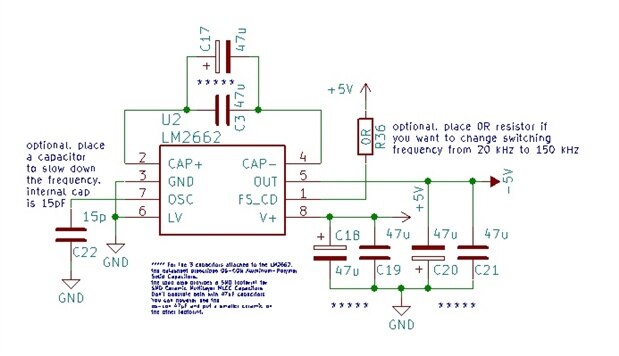

    In our electronic load, we use a LM2662LM2662. It's cheaper and doesn't need an external inductor.
    edit: the unit of the inductor in your schematic is uF. Shouldn’t it be uH?
    edit2: does the fan need regulated voltage? Could you tap that one off before the regulator? Asking because it will cause most of the heat in the regulator. If the 28 V is too high for the fan, a few diodes in series can drop the voltage.
    jw0752 over 7 years ago in reply to Jan Cumps
    Hi Jan,
    Thanks for the critical look at what I did.  I will order in an LM 2662 to take a look at it. There was no particular reason why I chose a RH-2405 for the component. The inductor isn't needed in the circuit for operation but was listed as an EMI surpressor. Yes the units on the inductor should be uH. I use inductors so infrequently compared to capacitors I guess my mind was locked into the wrong units. No the fan probably doesn't need regulated voltage. I doubt that the difference between the 28 volt supply and the regulated 24 means much to it. It is just how they designed it and sometimes I don't sufficiently question what is already there. It is a tiny fan and has only like 30 mA draw so the current times the voltage drop is only about 120 mW.
    I have a question to bounce back to you. Why is it that it is so hard to improve the ripple on the output? I would expect a decoupling capacitor to absorb the ripple and improve the output but it doesn't seem to help even under no load except the scopes probe. This is a question that I have encountered many times and this is a good opportunity to ask it.
