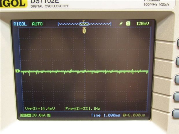

    I have a question to bounce back to you. Why is it that it is so hard to improve the ripple on the output? I would expect a decoupling capacitor to absorb the ripple and improve the output but it doesn't seem to help even under no load except the scopes probe. This is a question that I have encountered many times and this is a good opportunity to ask it.
    Jan Cumps over 7 years ago in reply to jw0752
    John, I may be mistaken, but I don’t see any filtering on the -5 V rail.
    There’s switching going on inside the RH component and I expect that you see the artifacts of that switching on your rail.
    I just checked the specs and these components can have up to 120 mV ripple. You could put a lower than 330 uF capacitor over the -5 V rail.

    I went back to the bread board and conducted some experiments to see if I could affect the ripple. Thanks to your suggestions and some luck I was able to drastically improve it. Here is the amended schematic:
    The changes that made a big difference were the inclusion of a 330 uF capacitor on the input of the RH-2405. Putting it on the negative 5 volt rail had almost no effect. Also a 1 uF ceramic on the negative 5 volt rail also had a measurable effect. Here is a photo of the oscilloscope reading of the rail after the changes were made.
    This looks like a 1 order of magnitude improvement to me. It surprised me that the bulk of the problem was coming from the input side. This may not have been a serious contributor on the circuit board as the supply voltage rail would have been shorter and more robust. On the bread board however I have 3 feet of medium gauge jumper wire back to the power supply. In any case I am pleased with the improvement and once again thank you for taking the time to give me some great insights.
