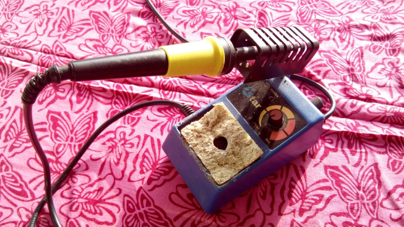

    balearicdynamics over 10 years ago in reply to jw0752
    Hi John,
    thank you for the support image
    First of all, of the Weller I think that my soldering iron has just the colour image image (take a look to the just-done-now photo below).
    This is old and crap and almost burnt. With the same problems. But at a cheap price I have found nothing more than this, so the idea is to start from some other soldering iron similar to add the improvements you suggest. Especially the turbo / normal heating circuit and the temperature control.
    About the thermistor, I suppose that - without it - the temperature regulation has been done without feedback but only based on the pot regulation, is correct ? How did you managed the thermistor with the feedback? And was it sufficient to place in a location that it is only when the solder iron is put when it is not in use? I suppose yeas but frankly it is a detail that I have never considered.
    Enrico
