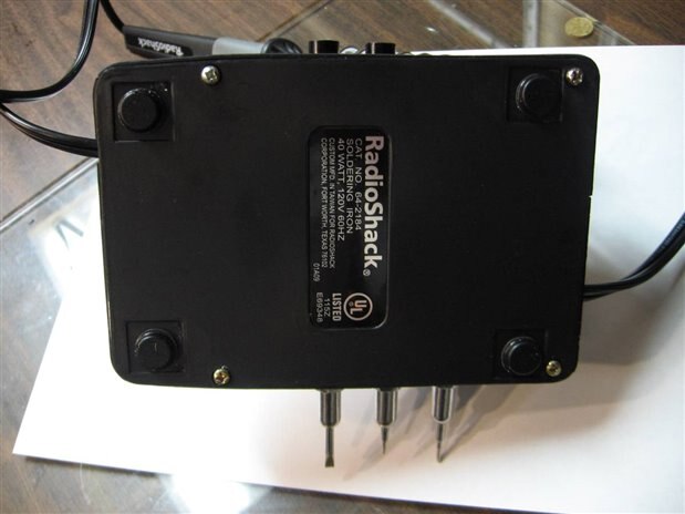

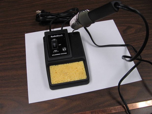

For many years this has been my soldering iron. I have liked it and continued to use it because it gives me a choice of a high 40 watt and a low 20 watt heat setting. I also like the variety, durability, and economy of the tips that are available for it. Here is a link to the type of tips that are used. It is manufactured by Weller but I am pretty sure that it was an Ungar design originally.
http://www.newark.com/weller/pl113/tools-soldering-tips/dp/33F681?ost=Weller+Solder+Tips&categoryId=800000006341
Here is the list of the things that I do not like about it which will be corrected or ameliorated by this modification.
(1) The heat is either too hot or not hot enough for my needs depending on the high - low setting. I can work with the High but it tends to oxidize the solder too quickly which leads to the need for frequent cleaning and re-tinning. The Low setting is ok for very light work but doesn't have the power for larger joints or thick copper traces.
(2) The designer of the solder iron was apparently an artist not a user of solder irons. By designing so that the handpiece wire exits from the back of the unit we get a pretty unit but it is a functional disaster. The problems caused by the wire exiting the unit from the back are: 6 inches of length are lost, the wire is always in jeopardy of being melted by the tip, and the use of the iron causes a torque on the unit that spins it around.
(3) The unit is too light to be stable and is always shifting and moving around when the iron is being used.
These are the goals that will be addressed by the modification:
(1) The exit for the handpiece cord will be moved to the front of the solder iron stand.
(2) Weight will be added to the stand to increase its stability.
(3) A triac controlled dimmer circuit will be added to allow the selection of power to the tip of Zero to Forty watts.
(4) Test points will be provided on the outside of the station to calibrate the voltage to the Iron.
(5) A rack to hold the extra tips will be added to the side of the station.
(6) A sensor circuit will be incorporated so that full power is used during warm up and if the solder iron is off the stand for more than a minute.

The modification was begun by moving the exit for the handpiece wire from the back of the unit to the front. The 1/4 - 28 spare solder tip storage mounting screws were also installed.
Next a 4mm thick plate of aluminum was cut to match and replace the original plastic base plate of the iron. This aluminum plate will also serve as a heat sink for the Q4015L5 Triac though it will not really be needed.
The control, power switch, and LEDs were mounted into the redesigned front panel of the unit and the circuitry for the dimmer was attached to the base plate. The Q4015L5 is an isolated tab device so it was mounted directly without the need for mica or isolating washers.
