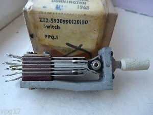

    For a while in mid 70s the business my Father and I ran did a lot of work for the Post Office which became BT during that time. We made test gear for the telephone network and were one of (if not the) last manufacturers in the UK of the original style Post Office key switch.
