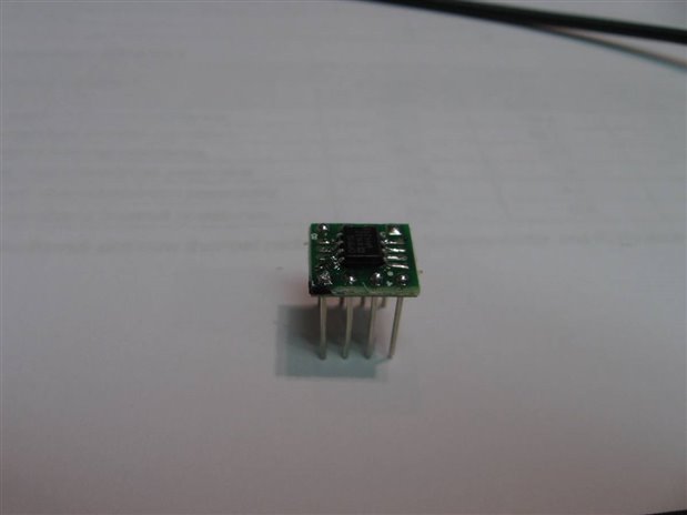

One of the really great things about the E-14 Web Site is how much one can learn just by reading and paying attention to some of the threads. On Jan 9th michaelkellett posted information on the OP191 and OP192 Op Amps which he likes to use in his designs. Being curious to play with them for myself I marked down the number and ordered some of the OP 191 for my shop. The OP191s that I received were in the SOIC8 package so it was necessary to mount it on an adapter board so that I could conduct some simple experiments on the bread boards. Here is the OP191 after I mounted it on the adapter and turned it into a DIP8.

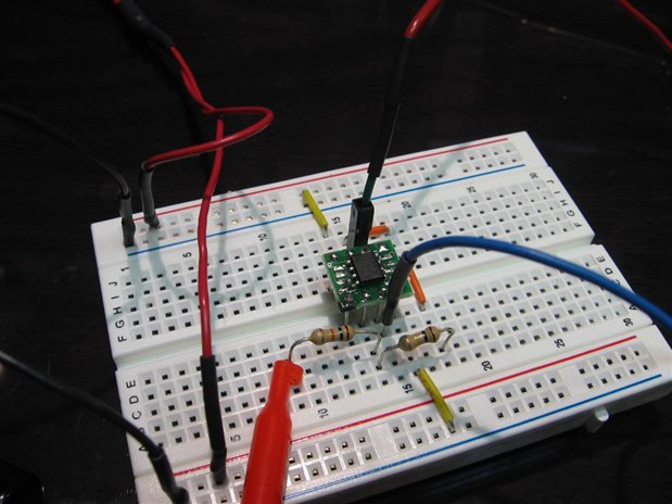

I next built a simple circuit with a gain of 10 and used my wave form generator and my oscilloscope to look at the limits of the chip and how well it performed. Here is the simple circuit.

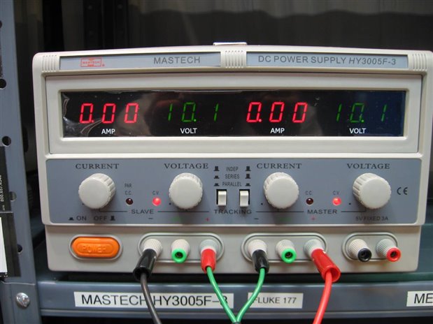

I used a +/- 10 volt supply for the chip and I ran the input level down until I could no longer get good readings on my scope. I was very impressed with how well the OP191 worked. Actually it doesn't take that much to impress me or to cover my needs. I could have taken michaelkellett 's word for it but what would have been the fun in that? The Op Amp did a very good job reproducing sine, square, and ramp inputs.

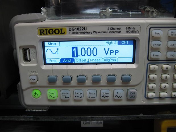

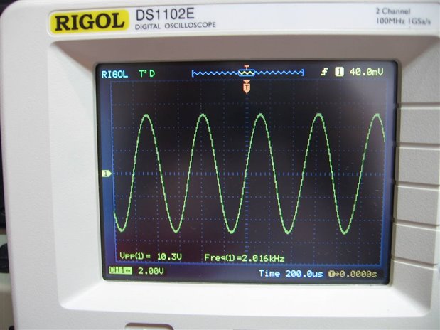

Here are the readouts of the test equipment during one of the experiments on the Op Amp.

    I glossed over it in my post, but there are two main effects that roll off the response at higher frequencies. One is the decline in the open loop gain, the other is the slew-rate limitation of the output…
  • jc2048
    jc2048 over 10 years ago in reply to jw0752 +2
    Your roll-off is much earlier than the datasheet would suggest (Figure 15). It's a bit difficult to read, but at a closed-loop gain = -10 their graph shows the actual gain falling by half (-6dB down) at…

    jw0752 over 10 years ago in reply to jc2048
    Hi Jon,
    Thank you very much for your two comments. This may not be your specialty but you are still miles ahead of me. I did notice that the sine waves changed to ramps and your reply taught me that this is caused by the slew rate being too slow to keep up with the frequency. I agree that these little tests are not fair to the manufacturer but they are simply an attempt by me to better familiarize myself. When I use this Op Amp it is likely to be in a power supply or some other low frequency application. No that I know what the output should be I will do a little more experimentation when I get the chance to see if I can locate the cause of the quicker drop off in my measurements.
  • jc2048
    Your roll-off is much earlier than the datasheet would suggest (Figure 15). It's a bit difficult to read, but at a closed-loop gain = -10 their graph shows the actual gain falling by half (-6dB down) at something like 400kHz.
    Here's what the simulation output looks like with linear gain and frequency scales. This is with 500mV pk/pk in. This shows the gain being half at 500kHz.
    Wonder why your measurements are turning out different?
