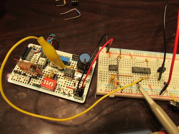

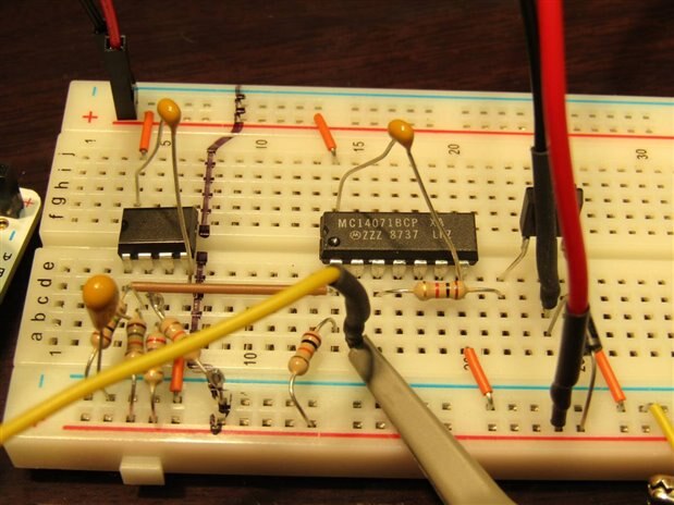

    Hi dougw  & Jan Cumps ,
    I have had a very fun night putting your two ideas on the bread board and experimenting with them. Here is the circuit and Schematic for the version inspired by Jan:
    This circuit worked very well. The resistors and capacitor used in the U3 comparator circuit produce approximately one second of full voltage to the peristaltic pump before dropping back to the level determined by the 555 PWM circuit. The prototype board on the left is my PWM Test Jig which I use to save having to bread board a PWM circuit every time I need one.

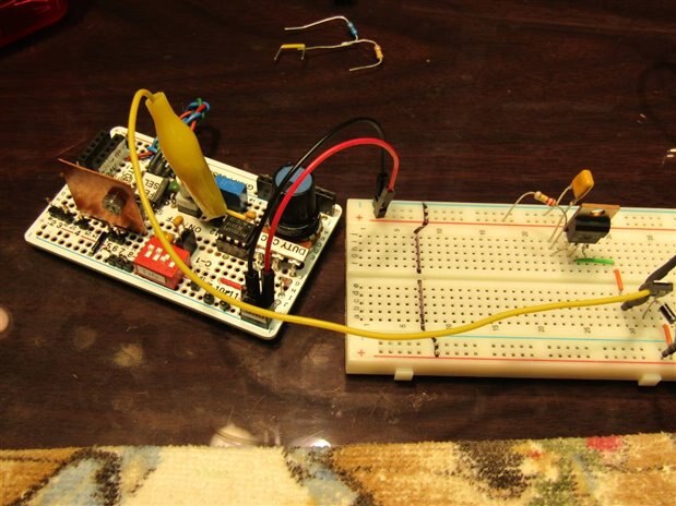

    When I returned to the forum to post my experiences and success with the circuit inspired by   Jan Cumps    I was surprised to find another idea for this modification from   dougw  . This new Idea inspired me to return and also breadboard and test Doug's suggestion. Here is the revised schematic for Doug's solution as well as the pictures of the test set up.
    I found this modification to work just as well and it produced approximately one second of full voltage on the peristaltic pump when I used 220K for the resistor in the RC circuit.  I learned a lot from each of these approaches to solving the need to add a boost to the pump on start up when the PWM driver is below 100%.

    dougw over 10 years ago in reply to jw0752
    A P-channel FET between the positive rail and the gate of Q2 could work.
    The gate of this FET would have a 1M pull-up to the rail and a 1uf cap to ground.
    The gate of Q1 will be high until the capacitor charges up, then the new FET is dormant.

    Jan Cumps over 10 years ago in reply to jw0752
    Say Hi to Mom, and good luck with the experiment.
    jw0752 over 10 years ago in reply to Jan Cumps
    Hi Jan,
    I really like your idea to start the pump with a 1 or 2 second full power boost. From your good description you have done all the hard work for me already. Tonight I will start the fun part and try to breadboard the circuit that you described.
    I will tell Mom today about all the help I am getting designing her drinking machine from engineers all over the world. She will get a kick out of that.
