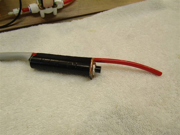

I began the project by collecting a variety of potential components. My Goal was to draw her thickened water from a reservoir and pump it up a line and into her mouth. She is accustomed to using a push button call switch when she needs help from an attendant so I decided to use a very similar switch to actuate the pump.
The water line would run axially with the switch and its wiring. The switch could be held in her hand and the water feed line would continue past the switch by about 4 inches.
Picture of Hand Switch
