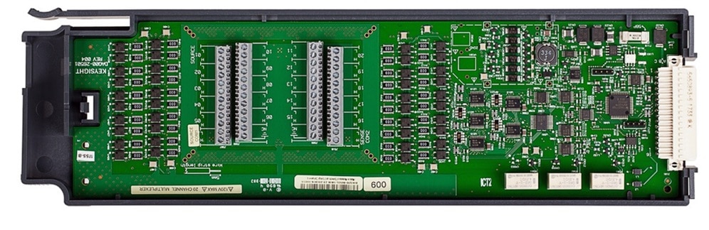

I have a DAQ970 system with a solid state multiplexer and that can be used to measure the output of the current shunts as well as the input and output voltages.
(The output of the current shunt is to low to get the best out of the DAQ970 so I use them with amplifiers  which are described later.)
Using the same instrument for all 4 measurements means that they all drift together as the instrument ages or changes temperature.
The basic voltage measuring performance of the DQ970 on the 1, 10 and 100V ranges is  good enough to meet the requirements.
    Do you have this one: DAQM900A 20-Channel FET multiplexer module?

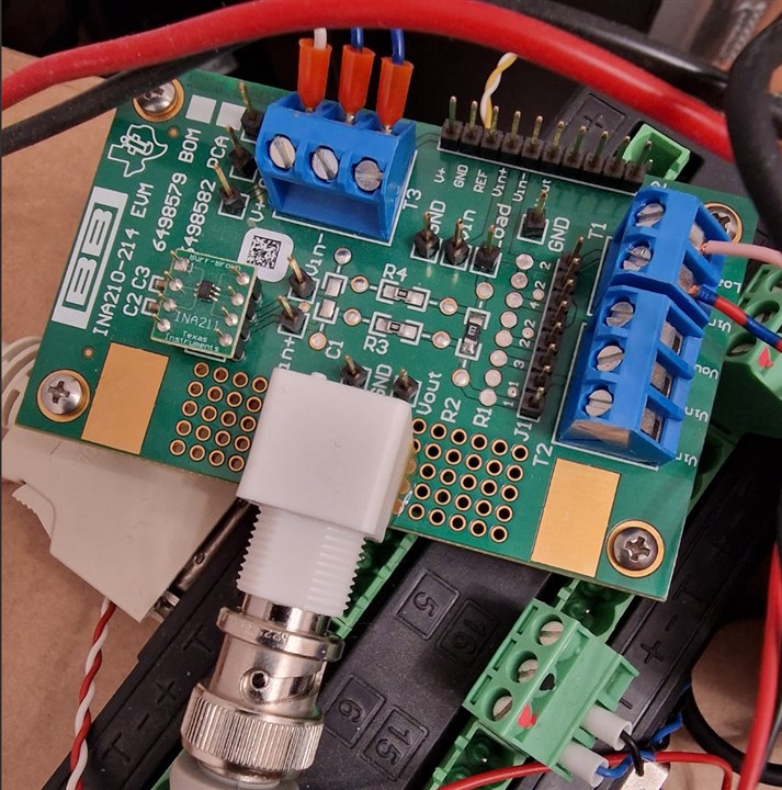

    For the current measurement, my needs were just to support up to a few hundred mA, and I often use a INA210-214 EVM board for that:
    That board needs two supplies though (ideally a slight negative supply like -1V, and a normal positive supply) otherwise the measurements have a slight offset. With the dual supplies, the measurements are probably as good as a typical 3.5 digit multimeter, so again nowhere near lab grade, but it was good enough for the simple Ni-MH test.

    > INA210-214 EVM ... probably as good as a typical 3.5 digit multimeter, so again nowhere near lab grade
    Most of my school lab days were spent on learning to deal with a given precision and resolution Slight smile
    First thing I do when using a 6.5 digit meter for some time, is to dial it down to 3.5. It's the sweet spot for many ad-hoc measurements.
