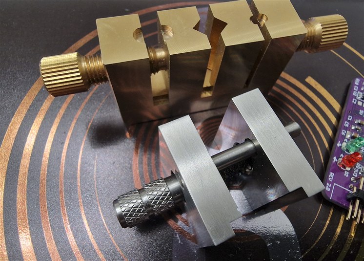

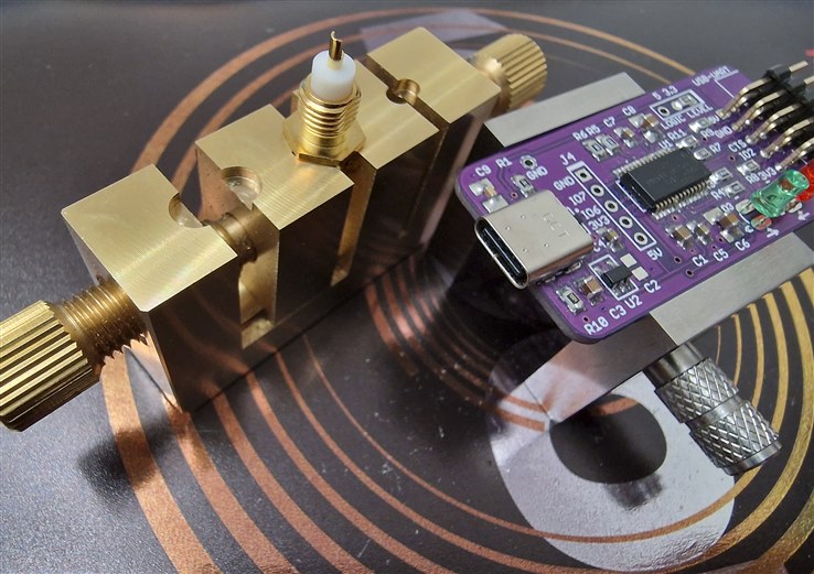

    shabaz over 1 year ago
    Nice blog post! It would not have immediately occurred to me how much accuracy was needed, I learned a lot.
    Very interesting resistor network parts too.
    By the way your photo with a vice reminded me to show a photo of these new ones I purchased recently.
    They are quite small. I actually got them for machining purposes, not holding boards, but they could be used to hold small PCBs or small cylindrical connectors etc since the brass one has V-notches.
