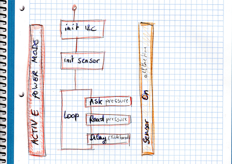

Barometer Firmware Flow
This is a straightforward design.
  • processor in active mode, peripherals on
  • !2c initialised
  • sensor initialised
  • a loop that
    • polls the sensors and retrieves the data
    • waits 500 ms
The firmware also logs info to the console over USB, but I deactivate these functions before making any power measurements.
This code (all printf() ) is just used during the development cycle.
Power Profile
As you can see above, the processor runs in the most power expensive mode. All the time.
I won't go over the options available to save power. That's for a next post. Just review where the inefficiencies are:
  • We always run in active mode.
  • all modules are turned on, also the ones that we don't use. Same for RAM.
  • We're using the maximum frequency of the microcontroller
  • in the loop - where the program spends virtually all of its active life -  most of the time is spent waiting, with the heating on image.
    the loop is approx 500 ms (a delay of 500, and a few ms to exchange data with the sensor)
  • sensor is powered all the time.
  • sensor is in active mode all the time, even though we know that it can start up and initialise in say 4 ms and deliver new data in 2 ms.

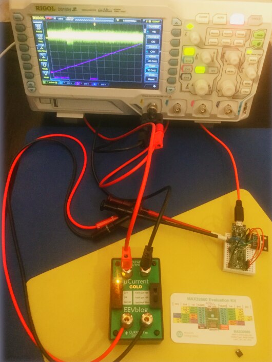

Measure the Consumption
I'm using my oscilloscope's integration function to get the power over a significant time.
I'll redo this exercise whenever I (think I will) make a significant power save step in future posts.

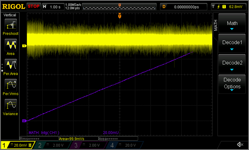

Current is converted by a µCurrent. 1 mV represents 1 mA. Power source is 1.8 V.
The time base is 1 second per division. Total 12 seconds. We capture 23 and a bit loops of the controller.

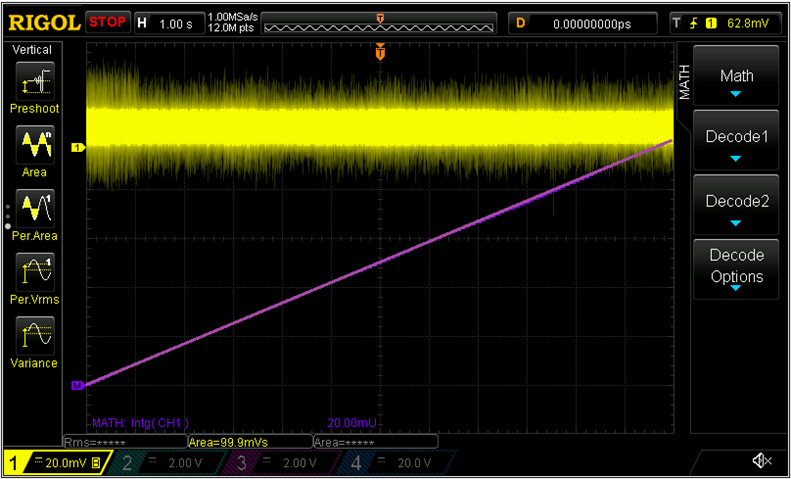

The A signal is set to 20 mv / division
Math is set to integral of channel A; 20 mUnits / division.
I've also used a measure to calculate the area under A. That should give the same result as the math signal at the end of the X scale.
I've redrawn the integral by hand for clarity (I haven't found a way to give the math channel focus on my scope).
Measure says I consumed 100 mVs. The math function shows just a tad over 5 divisions, 100 mUnits.
This is measured with the device in continuous mode, so the startup power is ignored. That's on purpose.
Now that I know that I've burned 100 mVs, measured over 12 seconds, I have a reference for the optimisation exercise.
Multiply by 1.8 V then divide by a magic number to know the amphours.
disclaimer: I haven't validated this. Maybe my reasoning is off and the measure vs math values seem to match by accident. I'd trust the math's integral value more.
But then I have to look up in the manual what 20 mU means, in relation to the settings of channel A.
If you know, tell me.
