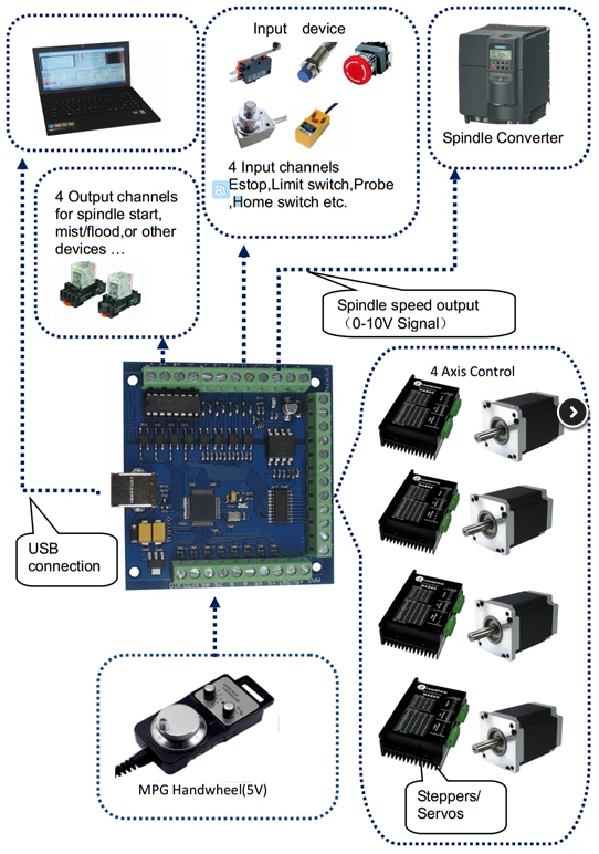

    Hi Enrico,
    There is a Mach3 version of my CNC router that interfaces with USB https://www.sainsmart.com/products/sainsmart-genmitsu-cnc-router-3018-mx3 and I think the control board would be what you need, but I don't think that SainSmart sells it separately.  Maybe you could ask them.  Seems to have a lot of good features.
    They sell interesting Mach3 USB controllers, but I think that they all require that you add the motor drivers.  You can search their website for Mach3 USB Controllers.  Here's one for example - currently only $59.  https://www.sainsmart.com/products/4-axis-cnc-mach3-usb-motion-controller-card-interface-breakout-board
    Ralph
    balearicdynamics over 7 years ago in reply to ralphjy
    Thank you, Ralph.
    This board probably is oversized for the small CNC I want to build - or, better convert/upcycle - from my 3D laser cutter structure. Instead, this seems very good to abandon the heavy desktop to control my big CNC with the parallel cable. As a matter of fact, this controller seems the solution. I should investigate and ask to the producer. One of the weeks of September I will be in Spain and one of the things I plan to do is just to make a decision with my big CNC.
