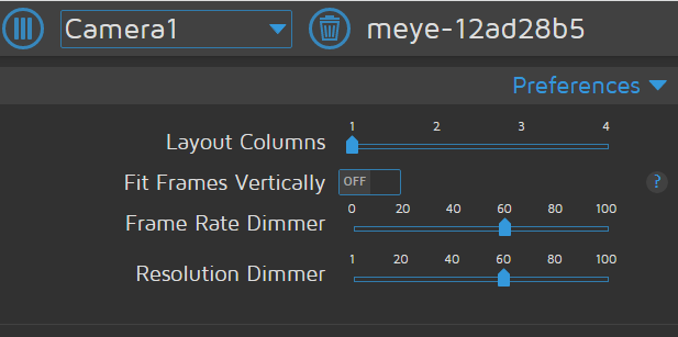

This is the MotionEye Console with the image preview and the video settings below that.  I set the resolution to 800x600 and the framerate to 15 FPS.

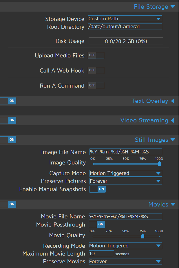

    I assume that you are using the link that I referenced in the post: https://github.com/jawsper/motioneyeos/releases/tag/20211113 for the image to load onto the SD card.
    Not sure what version of MotionEye that you are using on the RPi3, but the settings menu should be obvious.
    When you connect to the RPi, at the upper left there are two icons, one for settings and one for users.
    If you click on the settings icon it should open the settings menu (if you are logged in - won't open if not).  If you are not logged in you can click the users icon to login.
    If you scroll down the settings menu, you should see the settings for File Storage, Still Images, and Movies:
    If that does not work, I would try downloading the image again and rewriting the SD card.

    In the MotionEye i I can't find a movie settings menu, motion detection.... I have rpi3 b+ . Original pi3  version, there is an movie option, good. (Just on pi3)
