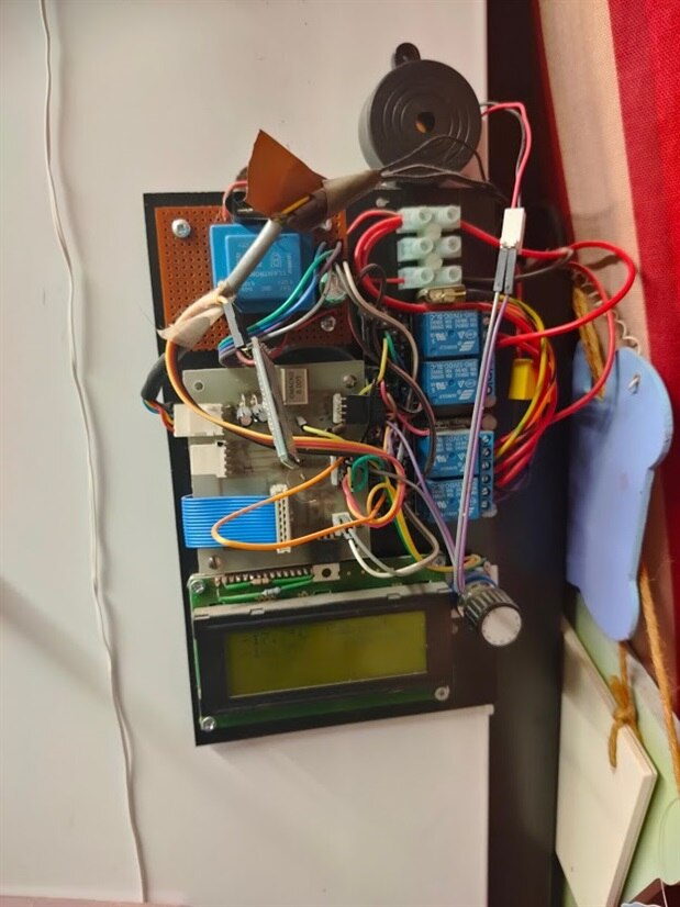

    About 7 years ago I got a panicked phone call from my wife who told me the tall freezer in the kitchen was making a beeping noise and it was quickly defrosting inside.
    I had to come home from work to try and save the hundreds of pounds of food going bad, when I got back home I found that there was no life in the freezer other than the beeping noise and a warning LED on the top panel inside the front door.
    I disassembled the controller on the back of the freezer, it's a large PCB originally intended for washing machines etc and repurposed for use on other appliances, the control panel at the top of the freezer communicates with it via I2C. Unfortunately the big PCB at the bottom was dead, only the power supply was working but the 'receiver' part (just another micro) was dead. Scoping the crystal showed there was clock activity but no response on the inputs or outputs.
    As a temporary measure I connected the compressor and circulation fan directly to the mains and plugged the freezer into a 24H timer, so it ran 45 minutes off, 15 minutes on. This worked for a few days but wasn't apropriate for long term as it wasn't temperature controlled and also the freezer is a frost free unit so the condenser unit fills up with ice eventually and an electric heater has to be turned on in order to melt the ice and restore efficient operation.
    My eventual solution was what can be seen in the pictures, stuck to the side of the freezer cabinet. It was only meant to be temporary but here we are 7 years later!
    The solution consists of cheap 12v relay modules which interface to the compressor, Fan and heater. powered by a nice reliable 12V linear mains transformer, and controlled by a PIC18F2520. It takes the inputs from the existing 10K NTC thermistors in side the cabinet and a potentiometer. It has an 4 x 20 LCD display for status information and also has a bluetooth module for communication, which I can use custom AT+ commands to check the status, log data and command the unit to run defrost or override the temperature contol input etc etc.

    14rhb over 5 years ago in reply to davegsm82
    I take my hat off to you for this 'temporary' fix image. If only manufacturer's adopted your design philosophy (with accessibility to the controller, relays and wiring) we'd all be in a much better place when it comes to repairing stuff. A big start would be running the appliance controller off a standard DC PSU along with an auxiliary feed input. IMO currently the board only costs a few percent of the overall retail price.
