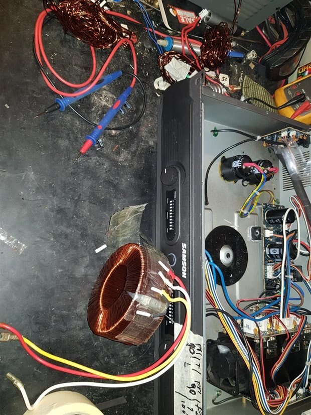

    Where to begin, there are way to many to put here but OK here is one most recently during lockdown.
    A Samson Servo 200 power amp blowing fuses. Most would assume Mosfet failure or something along those lines however all the power amp circuit was fine, all filter capacitors were fine and so was all the rectifier and regulation circuit.
    The toroidal transformer continuity tested fine however the inrush current limiter was burnt and cracked like a BBQ coal, the surge capacitors were exploded. Replacing these items made no correction to the fuse eating goblin Amp so a trick of the trade was needed.
    I placed an incandescent bulb in series with the mains input, yes making up a temporary circuit with some 2.5mm2 flex cord and a socket and patress on a plywood board then powered up the amp this way, the fuse did not blow and the bulb lit up. This told me the Toroidal transformer although testing fine with continuity and showed no short circuits obviously had a fault.
    I then began to unwind the toroid transformer winding by winding counting each winding one by one until I got down to the primary windings. There were no shorts, no broken enamel, no scorch marks at all anywhere in the transformer however, there it was the fault for anyone to see. The large thick gauge secondary copper windings were configured with the centre tap but instead of the copper windings being a continuous copper wire the centre tap was made of two separate windings with the centre tap being twisted and soldered together, the solder joint they used during manufacture had formed a dry joint. This is what caused the high current inrush, took out the surge suppressor and the inrush resistor and was eating up fuses.
    Cleaning up this joint, then using a 40w iron and some high quality flux and high content silver solder fixed it. The pain came when one had to wind all the turns of wire back onto the toroid one turn at a time and re-wind all the mica film tape, oh the finger blisters.
    Old amp which was discontinued and the part not available for purchase now repaired and tested working perfect. Just to make things more frustrating however, the manufacturer finally got back to me with the circuit diagrams indicating all the operating voltages to the input of the Power Supply board, so I could have had a toroid made to the now obtained specs, damn it.
