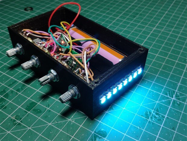

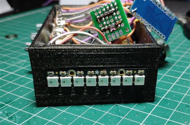

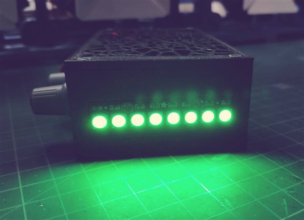

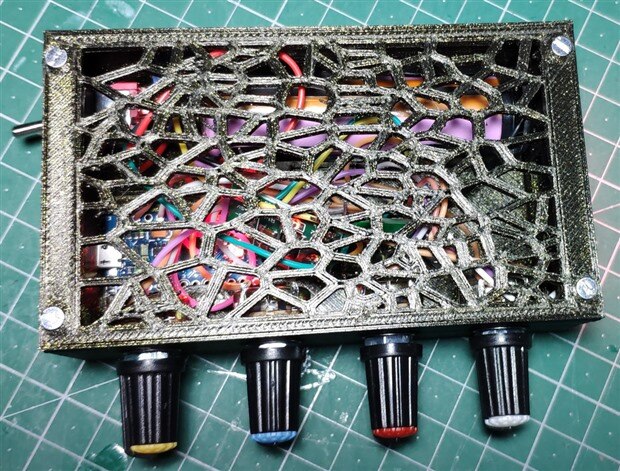

Hi all

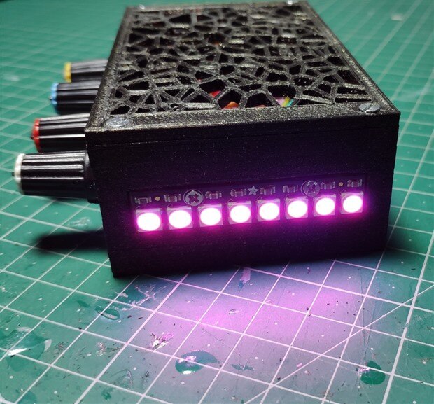

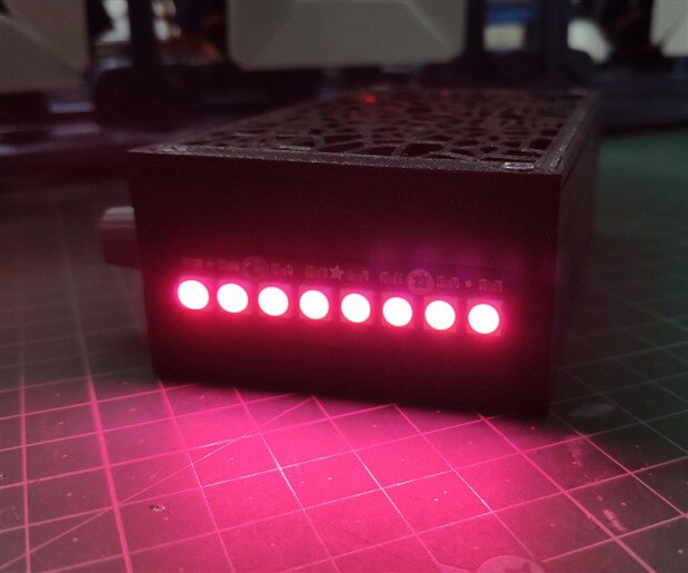

This is a project that I've build a time ago to have some ambient light in photos I've taken of some projects that I did to display in Arduino day in my town.
Using 4 potentiometers you can change the LED color and brightness .

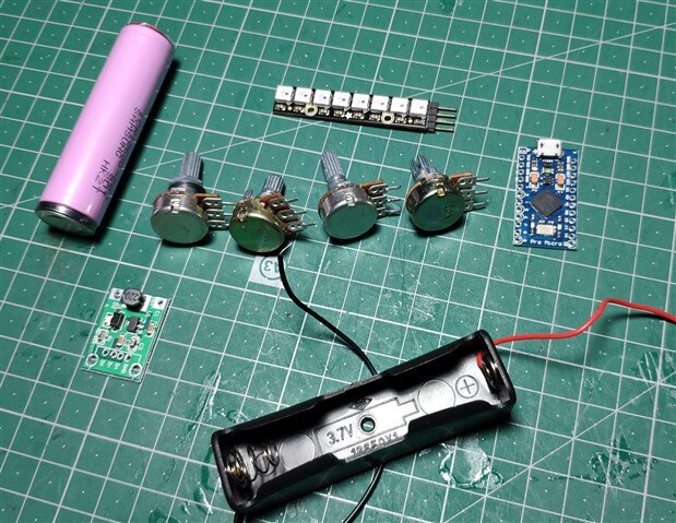

Materials needed
  • Arduino - I've used a Micro Pro
  • 4x 10k potentiometer
  • 1x Adafruit Neopixel stick - or compatible
  • 1x 18650 battery
  • 1x 18650 battery holder
  • Toggle Switch ON-OFF
  • DC-DC Mini Step Up Power Module 1-5v to 5v boost converter

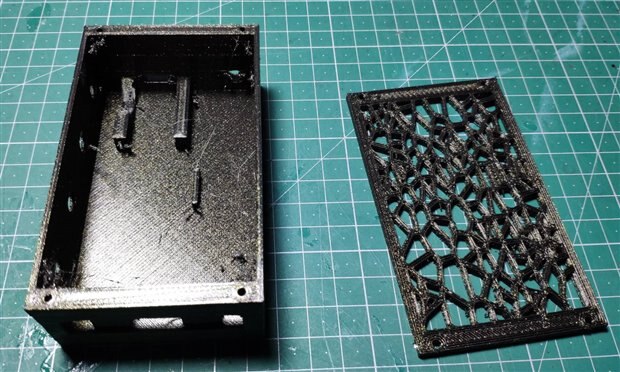

  • image

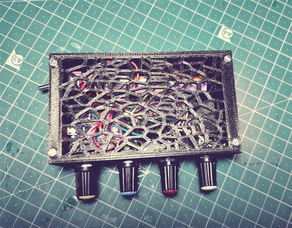

3D printed case

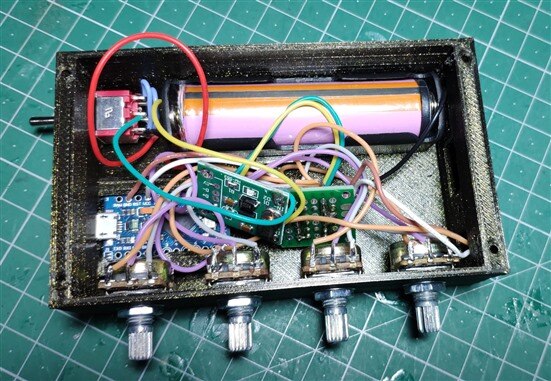

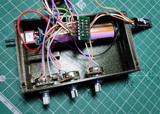

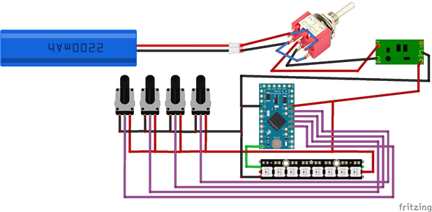

Following the schematics, the assembly is very simple.

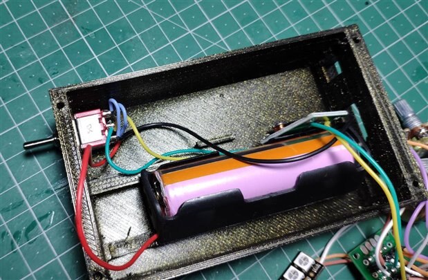

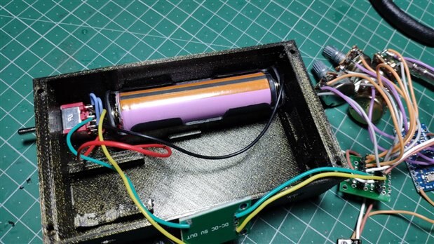

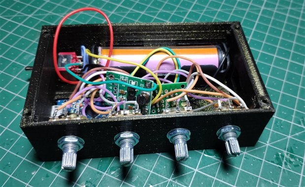

Wire the toggle switch to the battery and to the step-up .
Insert the battery holder next to the wall - there is a separator to keep the holder in place.
Wire all the potentiometers and the Neopixel strip
Everything wired
Let it be light

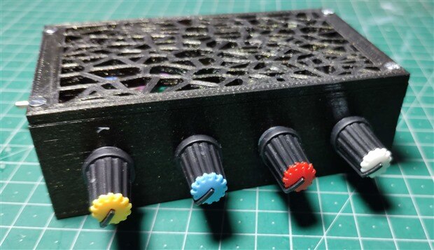

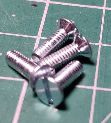

Use 4 M2.5x7 screws to close the LID
