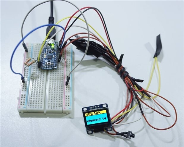

Step 4: Breadboard the circuit.

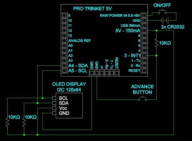

Before installing anything, test it on a breadboard. That way, it will be so much easier to troubleshoot. See the electrical schematic in Figure 4.
Figure 3: Breadboard the circuit before installing it.
Figure 4: The electrical schematic for the Screen Ring.

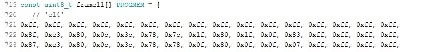

Step 5-2: Create some sweet bitmaps for the ring.
The Arduino code cannot read PNGs or JPGs and the like. It requires BMP images to be converted into data arrays which are then pasted into the code. One of the easiest ways to accomplish this is to use the online image2cpp converter. Just upload a BMP, convert it and then copy the generated code into the Arduino sketch (Figure 5).
There are some rules for getting the converted images to display properly. This can all be done in Windows Paint.
  • Images must be in black and white.
  • Images must be created with a size of 128x64 pixels.
Figure 5: The beginning of an array pasted into the sketch.
