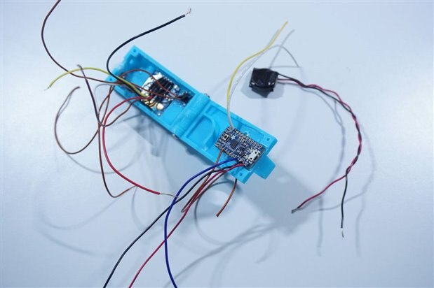

Step 6: Assemble the ring and install the components.
At this point, disassemble the breadboarded circuit and begin installing it into the ring. Glue and a hobby knife are essentials in this step. Unless you got lucky or have a printer that fabricates with a nigh-zero deviation from mathematical perfection, you will need to use a hobby knife to trim the printed parts.

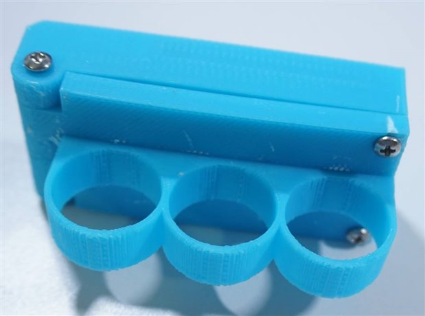

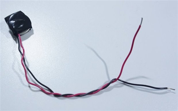

The power pack is made by sandwiching the batteries together with a positive and negative wire and wrapping the whole affair tightly with electrical tape (Figure 5).
Hot glue was used to fasten the parts in place (Figure 6).
The #4 screws are used as pins for the hinge and to fasten the ring’s lid down (Figure 7).
Figure 5: The ring battery pack. It is a bit inelegant, but it works.
Figure 6: Glue the parts into the ring.
Figure 7: The #4 screws fasten the ring together.

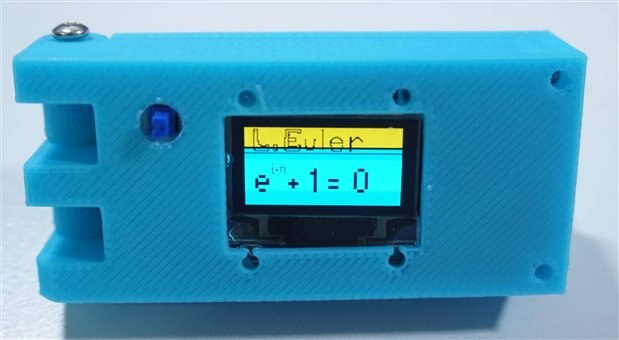

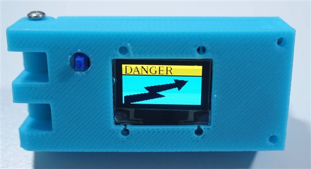

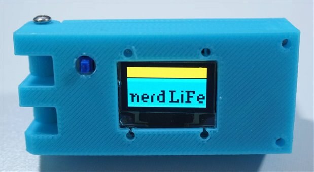

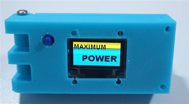

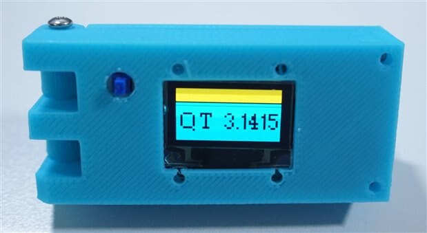

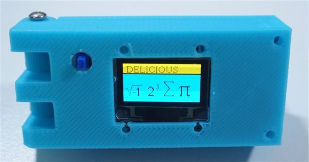

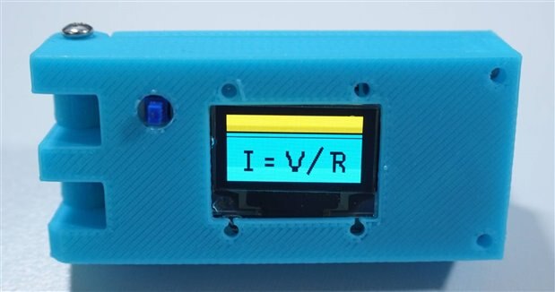

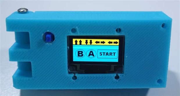

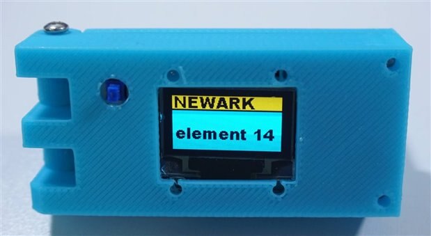

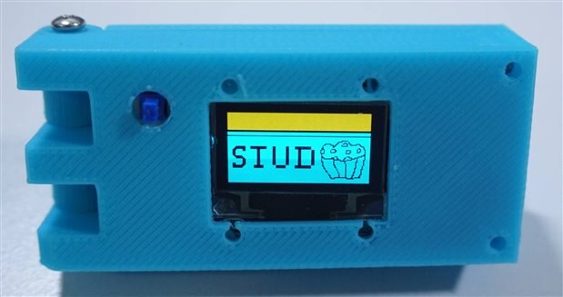

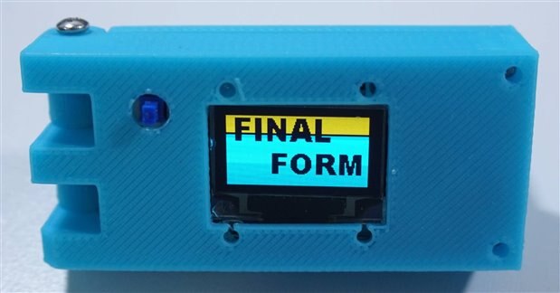

Step 7: Power it up and show it off.
You might want to create some fresh images for your ring. Our pics didn’t increase our popularity quite as much as was hoped. Here are a few examples.
