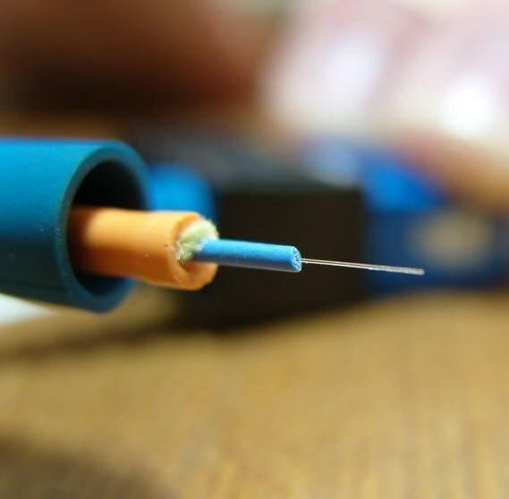

Fibre Optic
Everyone knows this is the stuff they send the internet down.  image
     Photo source www.orcon.net.nz
Well yes that is true, but those tend to be glass fibres and are a fixed size.
Wikipedia has a good summary of most uses here.
Optical fiber - Wikipedia, the free encyclopedia
They can be used to illuminate sensitive subjects, since they don't conduct the heat, UV or Infra red and their small size makes them very effective.
Low cost LED technology may have displaced this use in many applications.
Some people may know that fibre optics were used on some older automobiles to show the various lights were working.
For the 1968-71 Chevrolet Corvette they ran from a fitting in the light through the wiring loom to the dash and were probably a salesman's delight at the time.
Corvette questions | stevelinden
I've used Fibre Optics for Lighting effects in three of our Casino's, and some other locations.
We used 'End Glow' fibres to light up square blocks of plastic, or a device that looked like a normal light bulb. There was fascination amongst the builders when these 'light bulbs' changed colour. image
We also did a few Starfield simulations complete with 2-3m long shooting stars. (that is a whole other story)
The fibre optic generally used for lighting effects is solid plastic with a coating on the outside, and comes in a range of sizes from 0.75mm to 12mm diameter.
The advantage of the plastic means you can apply heat to the end, which creates a dome or lens shape, and of course you can glue/epoxy it.
If I use fibre optics then I have the means to transmit the light to a very small hole in a very small country.
