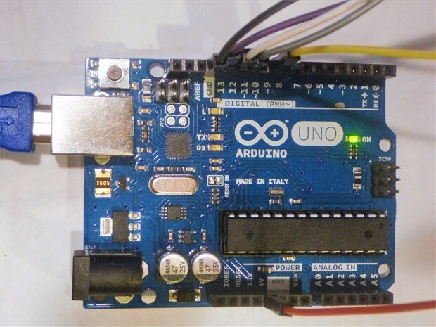

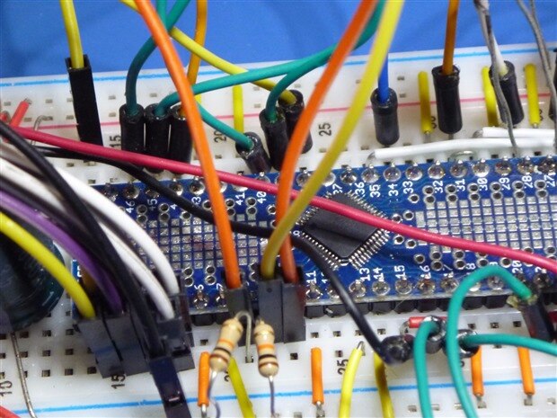

Here is my breadboard version and a view of some of the other end of the wires going to the Arduino UNO
This is the EVM module from the Road test, even though the chip is on an evaluation PCB with two VREFS and a bunch of switches, there should be no difference in operation of the software

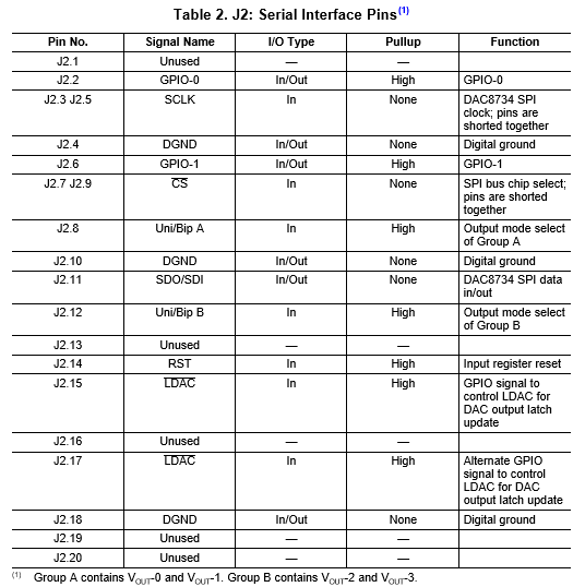

if your wiring to this then you will need to connect the SPI lines and power to the J2A pins (Right hand side of the EVM)
If you jumper J2.2 to J2.8 and J2.6 to J2.12 then after the SPI and power is connected, the board will work with my software in the same way.

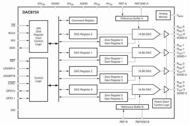

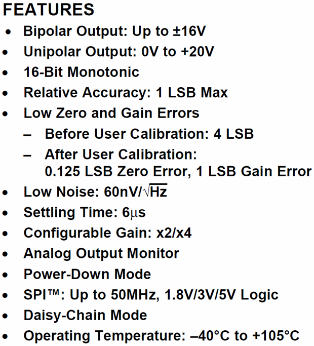

The DAC8734 stands out from many other DACs in that is can output upto +20V in unipolar mode and +10 to - 10 in Bipolar mode, this coupled with the 16Bit resolution and less than 1 bit error after calibration makes this DAC an Ideal candidate for my Power Supply project,
Here is a complete list of its features

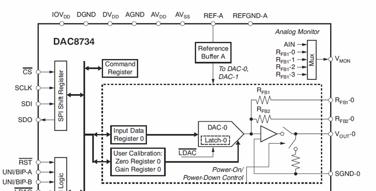

The dac consists of 4 analog outputs, a couple of GPIO pins, VREF inputs and the usual set of communications and power pins, here is a block diagram and a mode detailed drawing of one channel
One really cool thing to note here that is also fairly unique among DACs is the Zero and Gain registers, these allow the engineer to actually tune the zero offset of each individual DAC channel and also change its gain. this permits the engineer to not have to worry about software calibration that involves adjusting the actual Binary value being output to the DAC data registers, instead they can leverage the complete range of values (65535) for the best resolution. By making the jumper connections I listed above allows the engineer to also control the mode of operation for group A and B between Bipolar and Unipolar operation, rather then using the onboard switches or hard wiring it

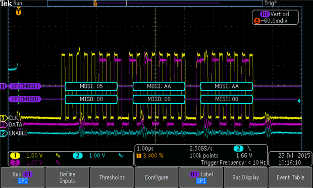

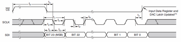

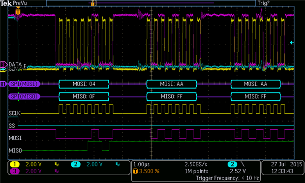

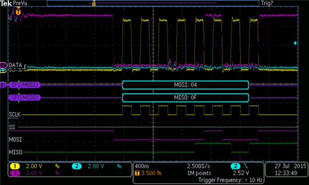

To say there were not any issues that I still have not resolved would be wrong. This is not a critical issue but on the PI and according to the DAC8734 PDF, the chip is supposed to work in SPI Clocking MODE1 where the data is changed on the rising edge of the clock and then latched into the DAC on the falling edge and this works perfectly on the PI (Once I figured that out image )
when I initially coded the cleaned up Arduino sketch, I set it to the same mode and it did not work. It was working before i tried to set any mode and simply accept the default, and I wrongly assumed that it was operating in Mode 1... wrong
Here is the timeing diagram from the PDF
the trace from the working RPI code
and this is what I had to use to get the Arduino working... just weird as the PDF has no mention of being able to reliably work this way... im still investigating
If anyone has any ideas, please let me know and I will try it out, for now be aware that you may also need to operate the DAC in this mode, even though it seems to be wrong (Yes I did adjust the Oscilloscope triggering correctly.. I thought of that image )

So lets look at the software. First let me say, I have tried to make it compatable with both the Arduino and the Launchpads and so far I have succeeded. there is an assumption that in all cases, where a board has a SS (Slave Select) defined, I have used it. this is all of the boards tested so far including the Arduino so here is the pinout I used for the Arduino
basically 10 is Chip select, 11 is MOSI (Master Out, Slave In), 12 is MISO (Master In, Slave Out) and 13 is the clock. this is all in hardware on the Arduino UNO with the exception of the SS pin that you still need to cotrol seperatlyimage

  • Robert Peter Oakes
    Robert Peter Oakes over 11 years ago in reply to clem57
    The Data line IDLE is different I agree but based on the spec, this should have no bearing but is the only tangable difference outside of minor edge level differences that should have even less effect, I will see if there is a way to get the Arduino to idle data low and see if this actually makes a difference, perhaps the DAC is noting this and changing its mode even though it is not documented
    I guess I did not explain well enough
    The two timing diagrams shown BOTH work. the first one is from the PI and is working in MODE 1 and is the only mode it will talk to the DAC in, the second two are from the Arduino (and the same basic Mode0 timing diagram is found with the launch Pads too) and is also working but as you can see it is running in MODE 0.
    If I change the PI into MODE0 or the Arduino into MODE1, neither will talk to the DAC. the DAC has no configurable features to allow this difference and its PDF clearly shows it needs to work in MODE1 so it makes no sense whatso ever but it is doing it and its like Woooaaaaa!, whats up with that!. I have not finished investigating but as this is also weird with the TI Launch pads I will raise a query with TI to see if they can answer this ?
