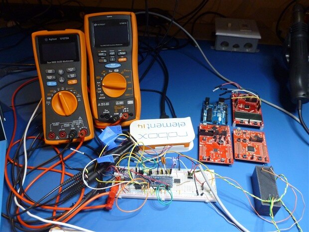

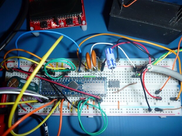

I also want to be clear, I dont have the DAC8734EVM to hand but I did get some DAC8734 Chips and mounted one on a breakout board and created my circuit on a bread board but there is nothing I am aware of that will prevent any of my software attached from working on the EVM
This is the EVM followed by my circuit
The objective of this post is to share my findings and experiance with the DAC8734, my initial intention was to evaluate it with regard to using it on my Power Supply Series and it just so happened to come up as a road test item also... Bonus.!!
I have created test programs for the Raspberry PI with Windows 10 for IOT (Detailed here), the Arduino UNO using the Arduino IDE and the TI LaunchPads (well several of them have been tested and there is very little difference between each one so only one sketch will be shown) and it was created using Enegia so anyone can use it with ease. even if there used to using only an Arduino.

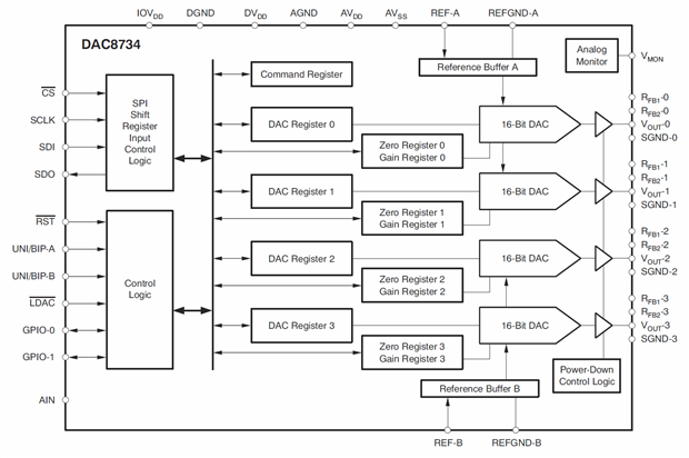

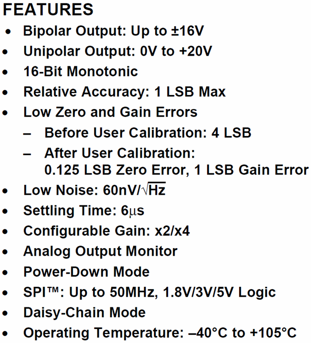

Right of the bat, the biggest two things I saw as a plus with this chip  were the fact it was 16 bit, Quad channel and most of all can output upto 20V in unipolar mode or +10 to -10V in bipolar mode, Ideal for my power supply control or related projects.

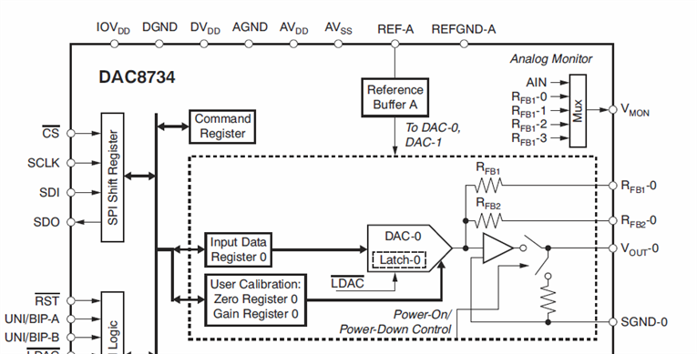

This is the internal block diagram of the DAC and a bit more detail of one channel (There all the same)
One of the more interestng features are the calibration registers that allow the programmer to adjust the DAC for 0V and full scale by setting values into two registers that allow the scale of the dac to be changed up or down, even above the normal DAC max output volts (Software typically only allows adjustment up to the MAX of a DAC by tweeking hte binary value prior to writing to the DAC)
The DAC is also broken int to two halves, Group A and Group B, each group has seperate VREF and controls for Bipolar/Unipolar and Power Down.

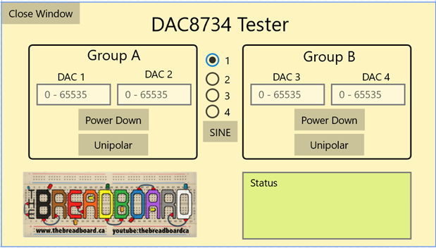

This is the view of the application I am sharing, it follows the same basic design of the DAC, I have not gotton too cleaver with it, for instance you still can only input 0 - 65535 rather than an actual voltage, irrespective of the mode of operation, but this would be an easy thing for anyone to add if they wish (I may even do it later)
on the Windows 10 side of things, I will show (In the post related to the software review) how a splash screen can be added as well as setting the program to automatically start. I will attach the complete project for you to get to grips with on this post though, so you wont have to wait.

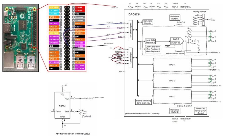

Here is a crude but informative wiring diagram showing how I connected up my version of the chip, A total of 6 wires from the PI, 3V3 and 0V power, then MOSI, MISO, CLK and CS for the SPI bus, I used CS1 on the PI for this sample.

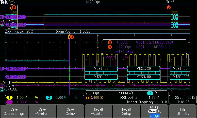

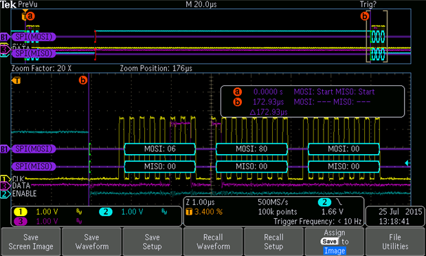

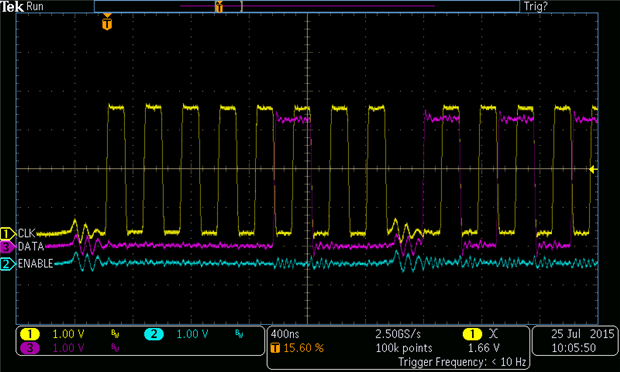

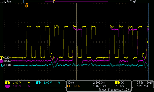

So I have shown in the past using the PI with Windows 10 for IOT and driving SPI devices, and in those examples I was using Mode 0 of the SPI bus for clocking etc. I initially assumed as I was also using TI chips that this mode would also work with the DAC8734... Wrong, It took me a while to figure out what was wrong but eventually I did, thanks to my trusty MDO3054 scope and the SPI decode module to make life a little easier. The chip requires Mode 1 of operation
Here are two captured traces, one MODE 0 and one MODE 1, see if you can tell the difference without looking up the SPI standard image. I will be posting a complete video and write up on this issue after this post and am keeping it seperate in order to keep the videos under an hour each (Yes I did hear you all from my previous posts). For now here is the teaser waveforms

One of the big issues I did observe while running under windows 10 for IOT was a very poor response to outputting a sine wave from an array of 256 16bit integers, I was able to get upto 250Hz on the arduino/Launchpads bit with the 1Ghz PI it was only able to complete a cycle of 256 points in 44mS resulting in a frequency of only 22Hz, so pretty bad really. I will be opening a ticket with MS regarding this and will keep you posted

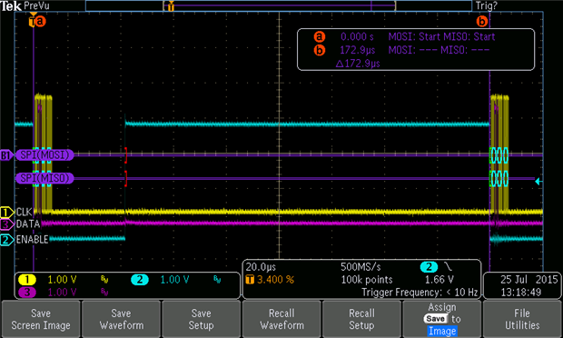

Here are the timeing diagrams for one period (2 sample outputs), the three diagrams show the complete cycle, the first 24bit output and then a subsiquent one. As you can see, there is a significant delay between the end of the data being output and the chip select releasing.
So if being able to output 256 samples in 44mS seems reasonable, if I simply comment out the lowest level write to the SPI bus I can, it will complete 255 loops of 256 values in only about 33mS equating to about 7.7Khz so if this had efficient lower level drivers perhaps the PI would still be able to output a 256 sample waveform at about 5Khz, that would not be too bad. Lets see what MS has to say and also what the release builds due out in a week or two will show.
