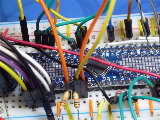

Here is my breadboard version and a view of some of the other end of the wires going to the Arduino UNO

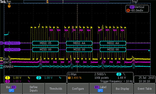

To say there were not any issues that I still have not resolved would be wrong. This is not a critical issue but on the PI and according to the DAC8734 PDF, the chip is supposed to work in SPI Clocking MODE1 where the data is changed on the rising edge of the clock and then latched into the DAC on the falling edge and this works perfectly on the PI (Once I figured that out image )
when I initially coded the cleaned up Arduino sketch, I set it to the same mode and it did not work. It was working before i tried to set any mode and simply accept the default, and I wrongly assumed that it was operating in Mode 1... wrong
Here is the timeing diagram from the PDF
the trace from the working RPI code
and this is what I had to use to get the Arduino working... just weird as the PDF has no mention of being able to reliably work this way... im still investigating
If anyone has any ideas, please let me know and I will try it out, for now be aware that you may also need to operate the DAC in this mode, even though it seems to be wrong (Yes I did adjust the Oscilloscope triggering correctly.. I thought of that image )
