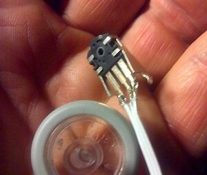

I recently gave some advice in another thread on reading the wheel from a wheel mouse (i think). Since I have seen no confirmation that my advice actually worked I went ahead and killed a wheel mouse, found and extracted the wheel encoder. This is how and what I did to read the wheel encoder from the mouse.
The wheel encoder from the dead mouse.
I made a small breadboard setup just to connect the wheel encoder and the arduino. I have no documentation of any kind on this part. After a short study of how it was connected on the original mouse PCB I had a theory. I named the connectors from left to right "B" "A" and "GND". The orientation of the wheel encoder in my hand matches the three round connections on the drawing below. In my test i used capacitors 1uF, but they seem to be a bit large. The reason for the capacitors is debouncing.
The waveform that i see when slowly turning the wheel looks like this:
So, if you trigger an interrupt on changes on the upper signal "A" while also reading "B" in the interrupt routine, You can determine both motion and what direction.
How do I determine direction? Turning the wheel is like moving the vertical bar left or right over the waveforms. Every time the upper wave "A" changes level, i also look at "B"  and compare them. If I move right (turn wheel clockwise) I see "B" at the same logic level as "A". If i move left (turn wheel counterclockwise) I will always find "B" at opposite logic level from "A" when "A" changes. Hence the code for this:

    Sorry, I think it was my post. I have been buisy and hade some issues with my Arduino I will try this when I get some spare time. Thanks for the post!
  • chgus
    chgus over 14 years ago in reply to e14 Contributor
    No problem, just that curiosity got the better of me ...  image
  • coolbots7
    coolbots7 over 14 years ago in reply to chgus
    I wasn't thingking of using capacitors does that make a difference?
  • chgus
    chgus over 14 years ago in reply to coolbots7
    Yes, the interrupt response is so quick it will pick up the slightest noise. From my initial test i would say it find 50 false transitions with every true one. It might be better if it was an optical sensor. From the waveform i had above You may see that it raises very slow, so 1uF might be 2-5 times the value you actually should use.

    I noticed in your posted output that the encoder skipped some steps and went backwards. Were these erroneous readings or where you rotating the wheel back and forth? I am noticing from my testing that I am getting similar skipped counts.
